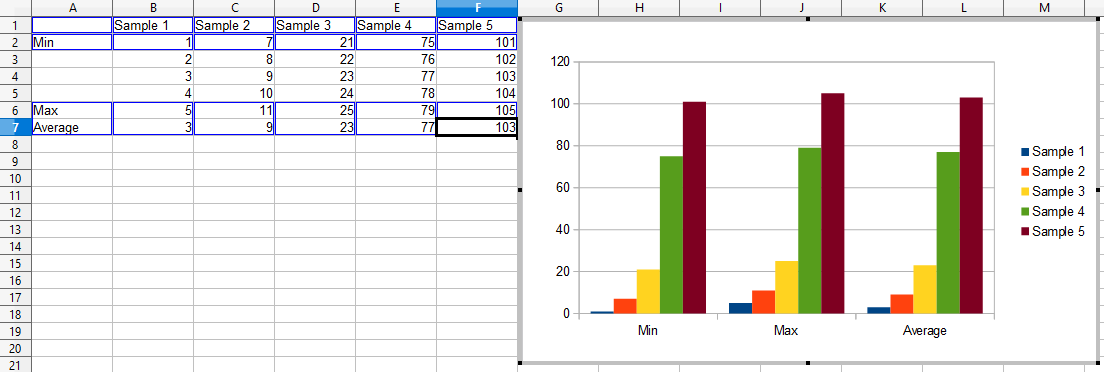

Had a quick go, hopefully this works for you?
Best I can do.
