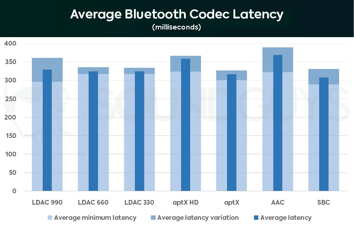

Lag only normally shows up in movies as lip sync issues (would not be so much an issue in listening to music) if you are too far away it gets worse and more soon higher quality codecs land the fix is to have both a Transmitter and ear/headphone that have aptX-LL or newer aptX-Adaptive.
AFAIR even normal aptX will have lower latency than SBC and AAC and esp high quality LDAC.

The higher quality the codec the less distance, so SBC is going to get further and use less battery and LDAC will be worse on both.

I have noticed my earbuds dosent use the LL APTX mode for some reason, it just uses APTX so theres quite a bit of lag when watching videos. I also have some headphones that uses SBC, and the range for those are terrible, 5-10 meters if your lucky, but theres no lag at all with them.
