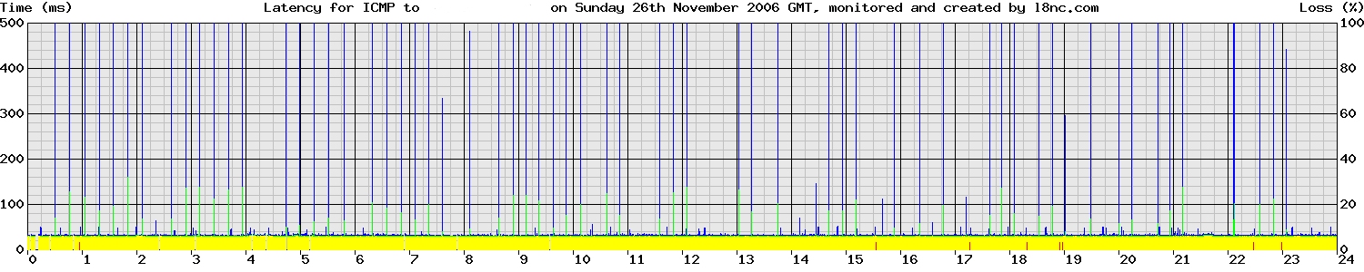

Anyone confirm a L8NC graph interpretation for me?

This.
There would have been no traffic on the line other than "chatter" as the office was empty on Sunday and the router isn't activated on our firewall (so no outbound traffic would have been routed down it).
What the heck causes spikes like that? Line fault?

seem's like a fault to me, your upstream is only 256 for starters, I take it you are on the MAX product?
you also seem to have a really low upstream SNR, call eclipse they will report it to BT as a fault, is it connected directly in the master socket?

Unless you live in the exchange, you will always have a low SNR on Max. 6db is considered the minimum for a stable connection, the sync speed will keep dropping down from 8mb to whatever speeds gives around 6db.
Try a new RJ11 lead between the router and the line, and a different microfilter - I found these made a significant difference on my Speedtouch 510. It also didn't like being plugged straight into the line with no filter, even though there was nothing else on the line.
Next, get your ISP to reset your BRAS profile (might be easier said than done with Eclipse though) and the line will find its optimum speed over the next few days. I had a similar problem where my speeds dropped to 256/3000 when they normally ran 448/6400, after the reset it went back to normal.
