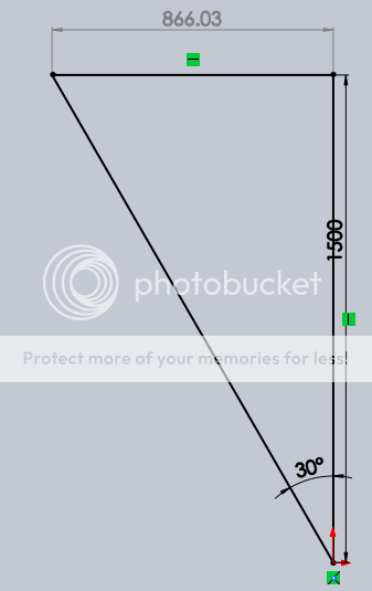

so you have basically 2 right angled triangles, the longest non-hypotenuse side is your 1.5m [to the centreline of the speakers] and you want these 2 speakers to be on a line crossing this 1.5m and a line that is 30 degrees off, something like this?
btw this is in mm ;)

And thanks to the results provided by SilverTongue, I've also worked out that at 30 degrees the distance will always be 115.4% of the listening position distance. Woop!
