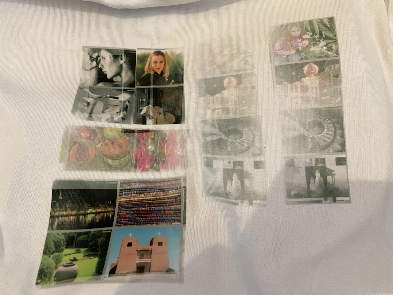

This is her test cotton t-shirt.. testing (a) heat levels, (b) heat duration, and (c) backing/non-backing etc. She used the little Cricut iron thing with the thermal ironing pad rather than using the big Cricut press thing.
Top left - with the backing support sheet material from A-sub, the lines through it are the edge of the support and not the ink jet clogging. So the woman is part on the backing sheet and part not .. so easily broken by stretch of the cotton. The backing material sticks to the back of the t-shirt but not like a patch more like it melts into the material. It makes it a little stiffer than the cotton without.
Top right without the backing support - not a good transfer.
Bottom left - again with the support material.
The colours that come out are vibrant too if the back sheet is used - we were worried about that but it seems to come out great.
