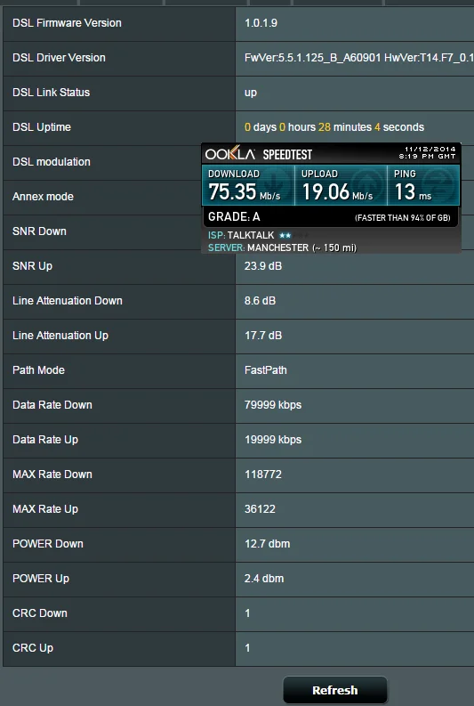

Still a little buggy in the GUI, but connection still holding steady I guess...
why not show your stats ? lol
well i thought i would give the latest beta a wurl even though i had a uptime of 14 days + lol
she is looking ok so far.

INP - This is independent of 'delay'. It doesn't seem to effect latency but does effect your sync rate (takes a chunk of it away depending on the setting).
Delay - This effects your latency, but does provide some means for error correction. Perhaps delay means the amount of time an error has in order to be corrected and not counted as a CRC (compared to the default of <=1ms on fastpath).
At least that's been my observations so far. Unfortunately I still haven't found a way to override the upstream parameters. This means on my connection DLM has applied an INP of 4 and a delay of 8 on my upstream, which I imagine it'll remove in the next few weeks as I don't get many errors on the upstream to warrant it anyway.
Access to stats
wan vdsl2 show mgcnt;tcapi get Info_Adsl lineState;tcapi show Info_Adsl
Out of curiosity, in which tool are you executing the stats command? I'm outputing the adsl stats from /tmp/adsl to the console which seems long winded - would be great to have access to the information another way.
Mine is doing the same while in interleaved. I can't make out if it's just the way it works, if it's reporting wrongly or if it's really errors being corrected. Personally I can't believe that many errors are happening. Surely there would be some noticeable throughput drop despite that many being corrected in such short time?
I got punished by DLM again whilst using the Asus on this new firmware, knocking me down 2mbps and increasing the Interleaving depth. Grrrr
One thing I pointed out to Asus which they have so far declined to answer is why my 'Attainable Rate' is almost 20mbps higher using the Asus compared to the 4 other devices I have. My theory is that its this that's causing line instability.
The ZyXel I have is so much more stable albeit at a lower 'Attainable Rate'.
So this router can let you alter the SNR on the downstream for a higher sync, say a 3dB profile rather than the usual 6? How does the DLM react to that?
