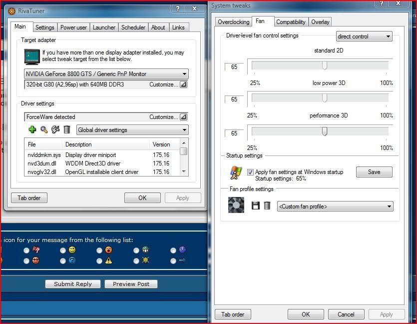

I've tried RivaTuner and Ntune but both don't work. The fan doesn't change at all when I try to manually slow the speed down.

Have you set up your profiles correctly though? Works fine here for that. Does the fan not slow down at all?
Can you just slow them down manually to try them? Here:
Yep, tried all that. My brother uses the same program for his 8800GTX and it works perfectly using exactly the same features in the program on his card.

This is a great way to control the fan in an 8800GT, way better than profiles and easier to set up. Hopefully it should work with an 8600GT.
http://forums.overclockers.co.uk/showthread.php?t=17849154
