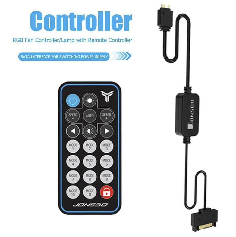

OK so here is one solution, I could use this to control the lighting on the Alpenfohn, it will run off a sata pwr, rather than use the Mystic sync header, and have its own remote,
But I'm confused?? (As usual) The Alpenfohn fan already has a separate 4 Pin PWM connector for the mboard, so it's speed will be regulated by CPU temp. So why does the remote for the RGB have the option to increase or decrease speed? Or is it just a change of light cycle speed, and I'm being a numpty?
Makes sense, thanks for the confirmation. So it looks like I'll have a remote for all my case fan speeds and RGB, a separate remote for my CPU Fan RGB, and my CPU fan speed correctly controlled by the mboard! oh happy days! it feels like a Kate Winslet moment, It's not perfect but it will do!
