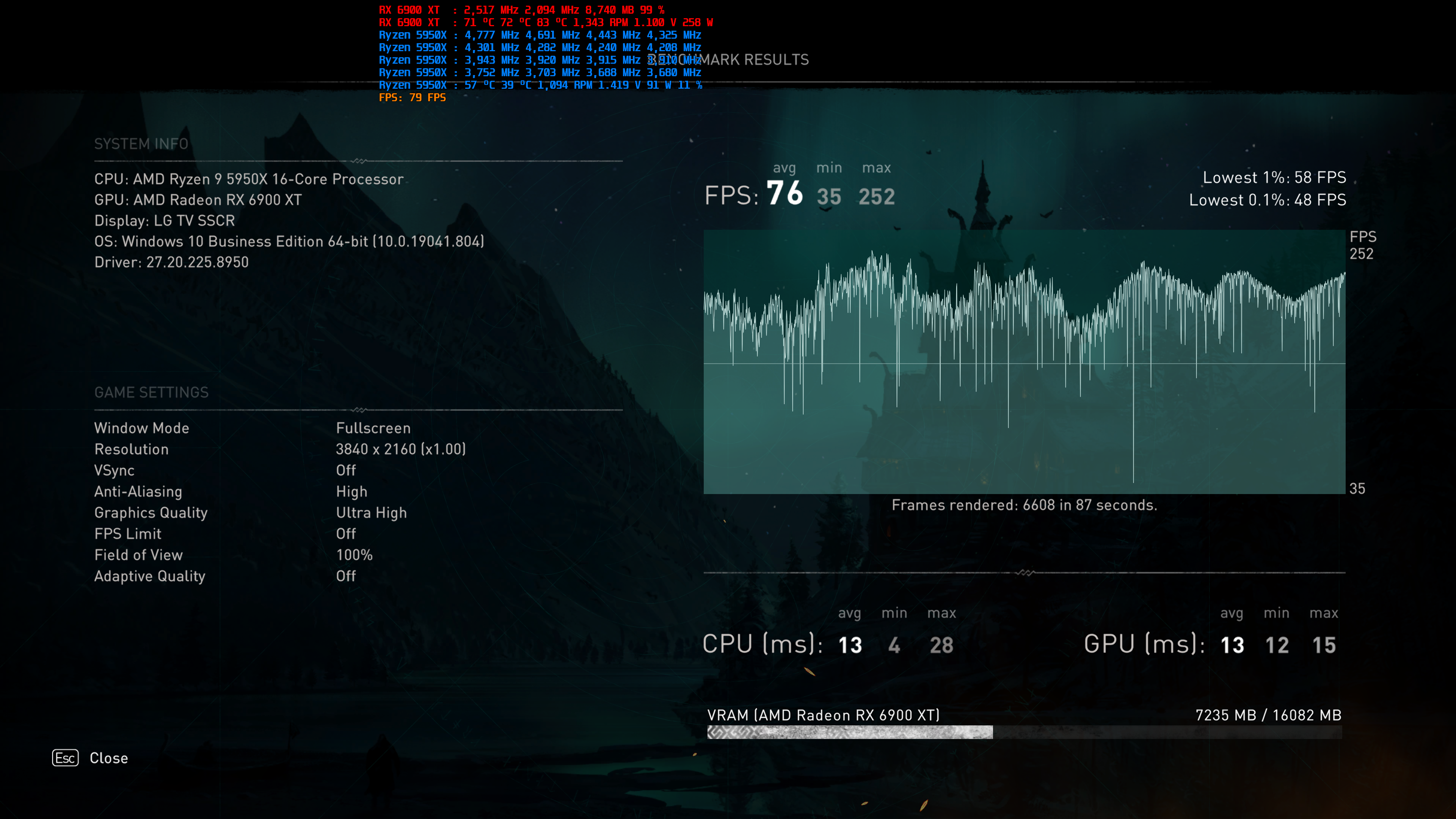

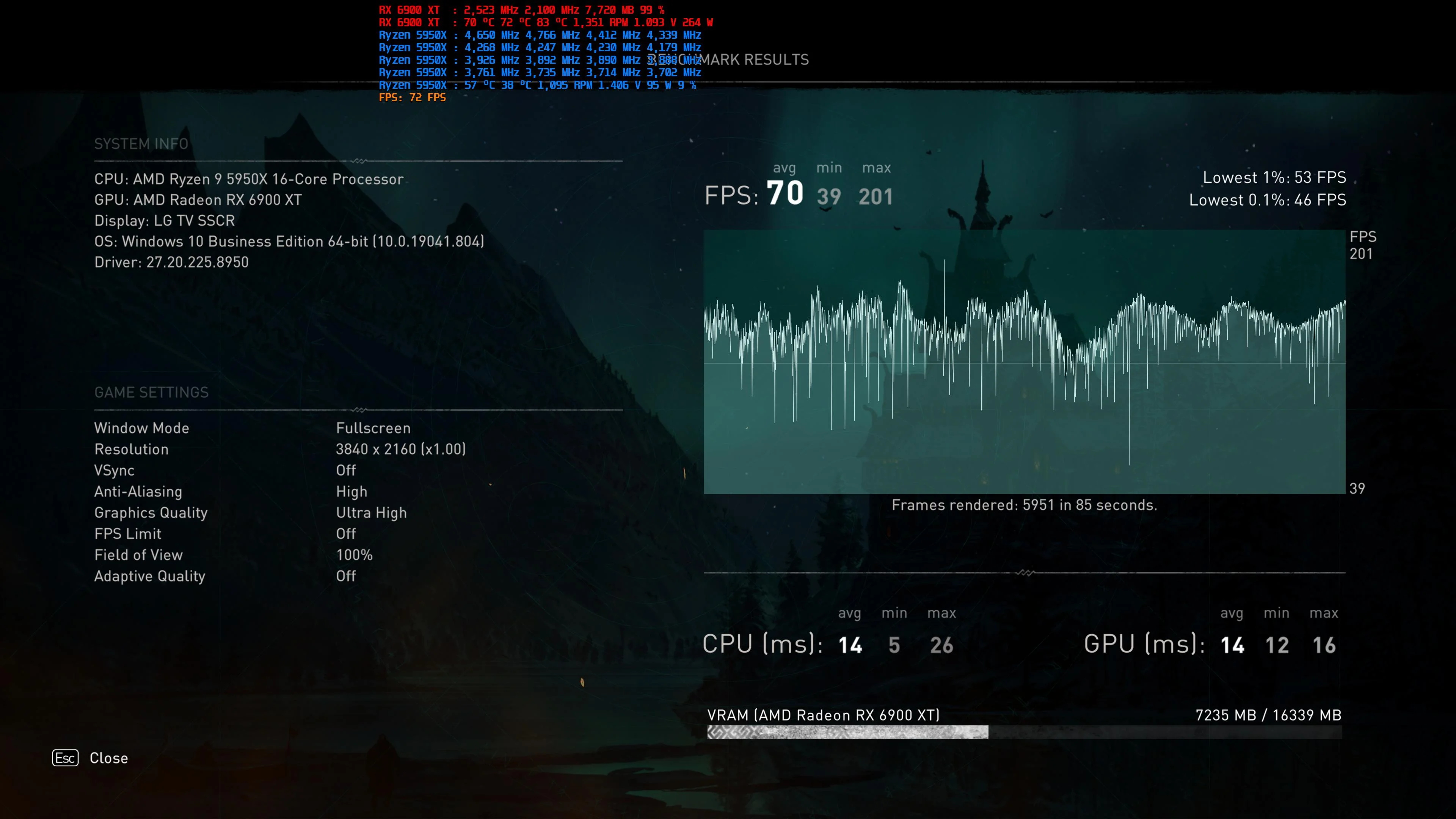

8.5% difference for me, just tested it with my 24/7 gaming clocks. More than i was expecting. Minimums were better with it off though.
2160P
5950x
2570Mhz/2112Mhz
21.2.2
Smart Access Memory On
Smart Access Memory Off
2160P
5950x
2570Mhz/2112Mhz
21.2.2

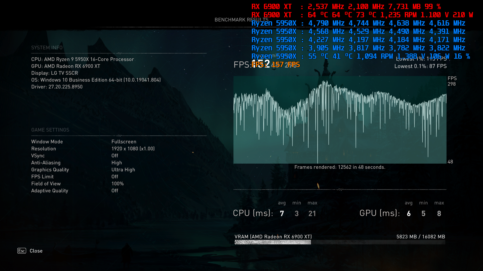

10.9% at 1080P. Didn't bother testing 1440P.
1080P
5950x
2570Mhz/2112Mhz
21.2.2
1080P
5950x
2570Mhz/2112Mhz
21.2.2

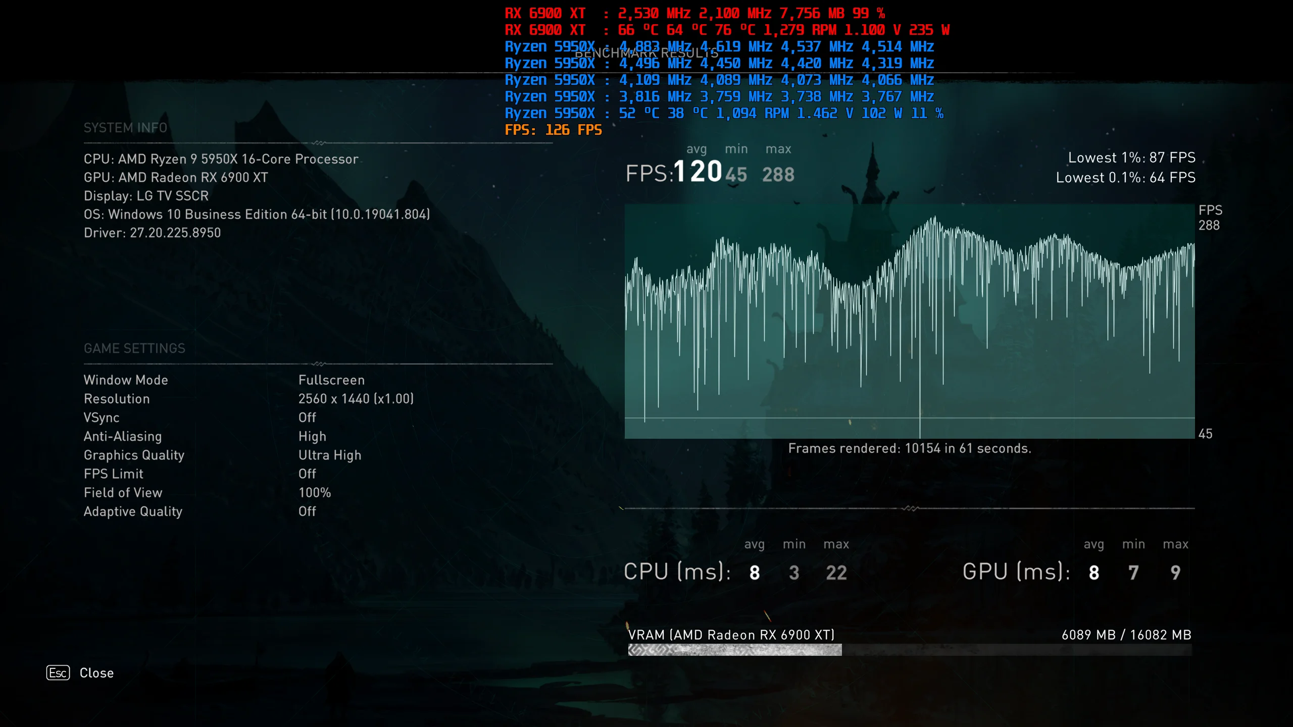

1440P
5950x
2570Mhz/2112Mhz
21.2.2
