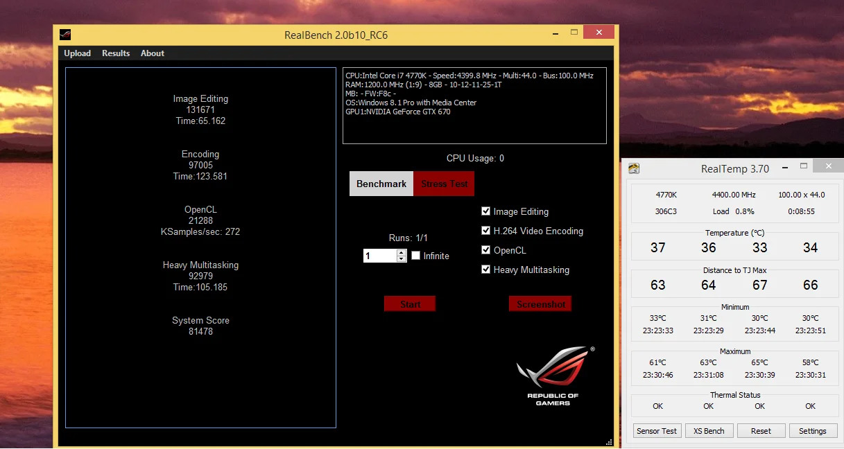

Asus Realbench 2.0
Quick run at 4.4ghz
I think memory timings play a part in the image editing test most definitely.
I suspect higher uncore/cache would help too. Also as this is very similar to the cpc bench, in wondering if running a few consecutive loops generates higher scores each time. Often ran two runs of cpc and the second always scored higher.

Upped uncore/cache to 4200mhz, and ran a couple of loops. Netted a few extra points.
Cpu @4.5ghz, ram @2400mhz, 10-11-11-31, 2T.
