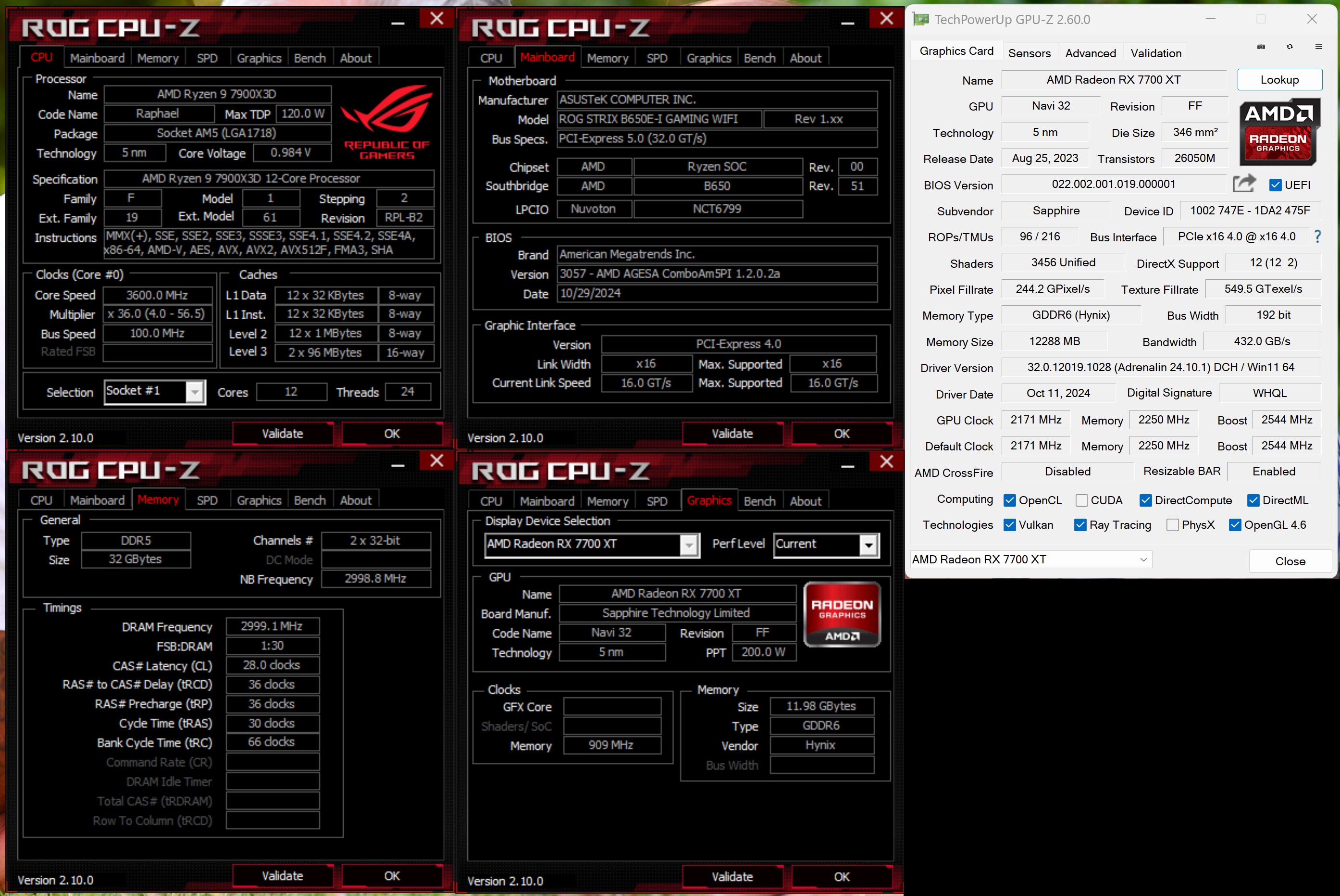

Would you mind showing the OP a screenshot from CPU-Z of your GPU running with 16 lanes? I don't think he/she believes us :D

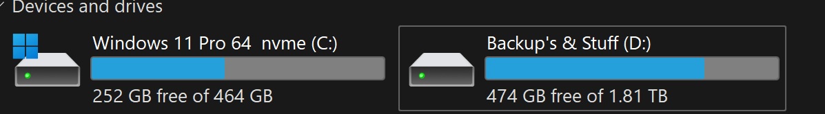

Sorry just got home from work, and nope they were wrong......sorry, excellent for RAM overclocks too, the GPU Slot is PCI 5.0 along with the front nvme slot and the rear nvme slot is PCI 4.0.
This is with GPU and both nvme slots populated
