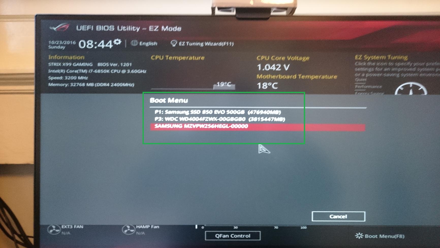

Thing is that Win10 works absolutely fine when you select it to manually boot, it's just the motherboard refuses to see it as a boot device (but still shows it in the drive menu). Interestingly it doesn't show my 4TB storage drive either:
Fuzz

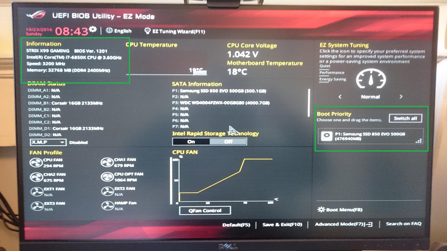

I'll need to look at my notes from 0801 / 1201 but I can see straight away you're vCore is lower on 1201 as you are running the same CPU as me. As I can see the vCore on your 1201 is 1.042v vs 1.174v on mine running 0801.
Ill also bet the CPU System Agent Voltage & VCCIO CPU 1.05V Voltage are running to a lower value.
Here is a screen shots from 0801, which is also clearly shows the memory running at 3200 but the voltages are higher.
To take a screen shot from the while in the BIOS, push F12 with a USB stick (FAT or FAT32) inserted. :)
Fuzz, thats an exact copy of my issue. Windows would boot fine as well but I wasnt allowed to select that drive in bios as the boot drive.
