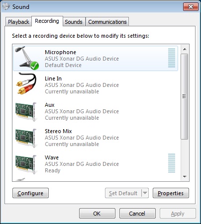

I've tried both:
and:
Both settings make no difference. Still absolutely nothing through the headset Mic. I was given drivers for the sound card from http://maxedtech.com/category/uni-xonar/ and I've also tried the official ones from the CD. Again no sound. Safe to say the mic port is faulty and raise an RMA?

But that's what I've done above? Set both line in and mic each time but still nothing?mi get sound from all speakers when I do the speaker test in windows so I do think I have the jacks in the right connectors otherwise some of the speakers wouldn't work. So I'm back to thinking it's the sound card.
