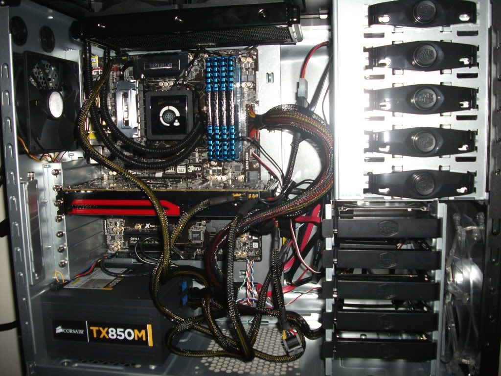

I thought I would give you guys an update. The case got an overall tidy.
Before the big tidy
My setup
Everything is running great, Playing BF3 on ultra at 1080. It plays TOR nicely, apart from the engine hickups with ilum and the fleet.
runs all my VST instruments within Abelton live.
But the heat on the 7970 is still 79c when I game. I have uprated the H100 fans to the 120ml Xigmatek orange fans due to the noise from the CPU usage. I did buy a 200ml Xigmatek orange fan to replace the coolermaster HAF922 front red fan. But with the mounts only one sided on the Xigmatek. Ill have to do that at another date when i have time to mod the case
But yeh, after a whole year of waiting for my inheritance. And a years worth of browsing the OC forums for much needed advice, I have my rig pretty much done.
The misses hates the wires ;)

See that fan mount in the bottom? you want one there with the airflow aiming up.
Then, buy some nice cable extensions and sort out that bloody rat nest man.

I will do m8, It is abit neater but not as neat as I would like it. To be honest I regret not buying the power pack with the braided cables.

You should notice quite a big difference in temperature by putting an intake fan in the bottom and tidying those cables.
Those are braided! :confused:
Get yourself some cable/zip ties and re-route some of the cables, tidying them up at the end. Will look much better but won't have a huge effect on the temps tbh.
Before the big tidy
My setup
If you can tidy the cables, and installed a 120mm fan (and a 120mm dust filter) to the bottom middle as intake that directing into the main chamber of the case and the graphic card's cooler's intake, it should give drop the temp by a couple of degrees. At the moment, your main intake (or should I said the only? :p) is with the drive bays in the way, so it would restrict the amount of air reaching the main part of the case. If you do not wish to do that, at least take out the 3 HDD holder at the bottom, so there would be more air getting through the drive cage. Personally, I would put the HDD and SSD at the bottom two slot, and take out the 3 drive holders at above.
