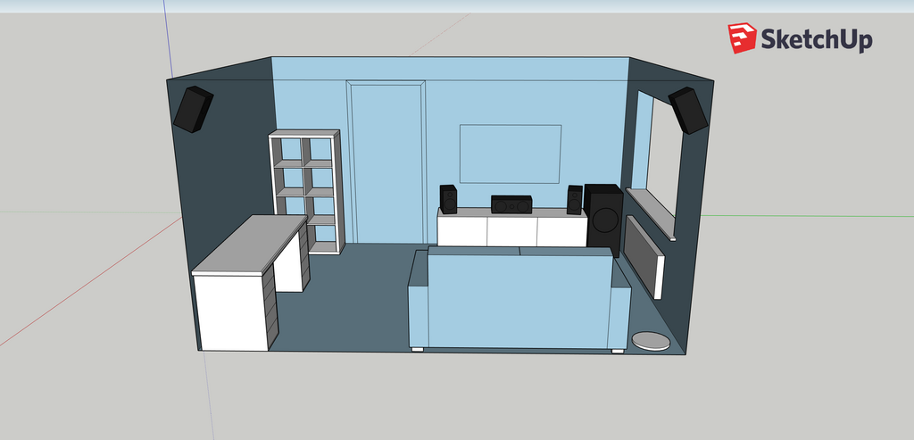

I'm looking to add an additional 2 speakers for 5.1.2.
My Onkyo receiver can be setup for front or rear heights.
What would be best?
1. Front heights, mounted on wall above front L&R
2. Rear/centre ceiling mounted above listening position?
The wall mounted option is quicker, easier and cheaper to fit, setup, and move if needs be.
Is it worth the extra cost and work to fit ceilings? I'm worried if we bought a new sofa and the listening position ever changed, it would need to be altered somehow.
