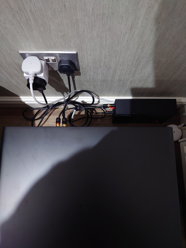

You would need to take out the pcb from the Samsung subwoofer and mount it into a box then pad down the amp output to speaker level inputs. That way you would be able to use any third party subwoofer and would also have zero lag between the sub and soundbar and the system would just be tricked into thinking the Samsung sub is connected to it, while allowing the third party one to work anywhere wirelessly.

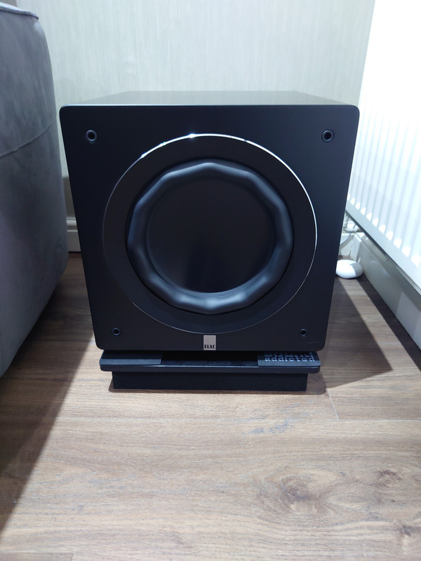

It's basically what I did on my Sony Bravia quads and works flawlessly. I went with an ELAC sub due to it having inbuilt calibration. If you go down the other route utilising the sub alongside the third party one, you'll get timing issues and will also be a horrible mismatch.
My friend could technically do the mod for you but he's based in Canada and unlike the Sony you can't buy the subwoofer separately, so would be rather expensive to ship him yours. I just bought a cheap SW3 off eBay USA and got them to ship it directly to him.
Below is the modded box he created for me which houses the Sony subwoofer PCB etc.
