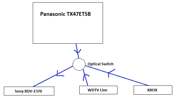

In the last couple of months I've got an intermittent issue where the TV picture and sound are not in sync. The video is faster than the sound by a few tenths of a second. Here is an incredible diagram of my setup:
All of the devices are linked by toslink cables so I have to turn the splitter depending on which source I want. I've had pretty much the same setup for 18 months without issue. This only started happening a few months ago when the following things changed:

**Edit** forgot to mention, the sound comes from the blu ray player rather than the TV speakers.
I doubt it's the switch as it's only one of these el cheapo jobbies:
So there's no software onboard, it's just a physical switch where you manually move the switch, so it's essentially just a cable extension. Plus I've had it all along without issues and the TV is connected using it which doesn't suffer from the delay
