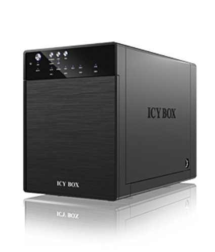

I've been considering spending the cash on one of the following: ICY BOX IB-3640SU3 4x 3.5 inch External 4-Bay JBOD Enclosure for SATA l/ll/lll HDD
Features
• Silent operation by thermal controlled fan
• Energy saving by supporting sleep modus
• Easy assembling by trayless design
• HDD capacity unlimited
• Supports: Windows XP/Vista/Win7, MAC OS X
• Plug&Play and Hot Swap
• Please note that a port multiplier is required for correct E-SATA functionality
What do you guys (and girls) think? It seem a sensible option if cost isn't an issue?
