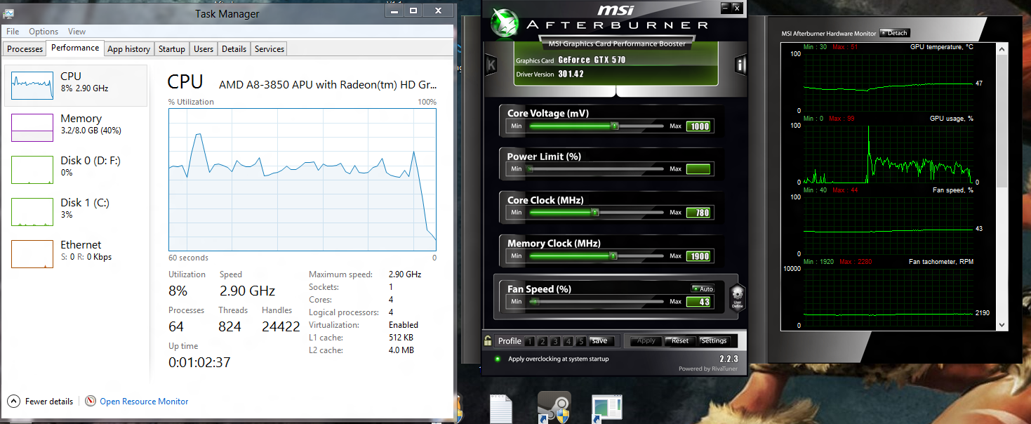

Ok, put it in the top slot, uninstalled and re downloaded the drivers, (301.42) fired up ARMA2, and still getting 10fps on stand still, and dropping below 5 when moving around (changed graphics from ultra to high didn't make a difference), this must be a CPU bottleneck problem then?
Install MSI Afterburner and Enable the On-Screen display.
Get a screen dump of the game with the overlay reporting VRAM Usage, Core % utilisation etc.
Let's work out for sure what GPU you are using while playing the game.
This was around 3seconds after playing ARMA2, I could not find the option to enable usage overlay, only temps. But this shows that it is in fact using the card.

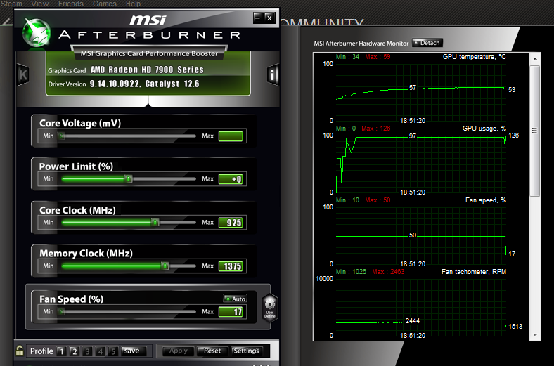

This was me just rendering the menu of Dawn Of War 2, this is what no CPU bottleneck looks like (Ignore that glitchy 126% like lol)
It's just pretty consistent.
