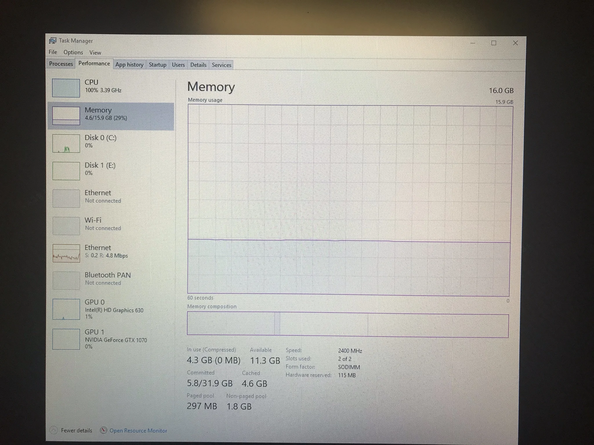

Screenshot of resmon (can get to it from the performance bit of task manager) on the memory tab could be useful as well.

Sorry for the crap photo is that where you mean, just done it on my phone for speed.
I was actually meaning the bit where it says "open resource monitor" at the bottom left - but that screenshot tends to confirm there isn't anything funny going on with hardware reserved memory, etc. which can sometimes cause issues like this.
