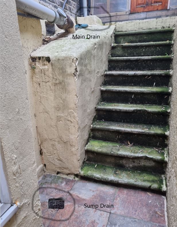

The photo shows the low-level drainage which could not cope. This is what i am hoping can be dug-out for a pump and cavity drain. Any ideas on expected costs ?
First thing, it might be worth getting your drainage runs CCTV surveyed. You may have a duff/collapsed outlet pipe. Or if not, the problem may be 1) too small a pipe out in which case you need to replace/attenuate at your end, or 2) backing up from the mains if it's overcapacity. The latter can be mitigated by a non-return valve (or by Thames Water cleaning their sewers if they're blocked with fatbergs). The former can utilise something like a waterbut or similar tank to hold surplus water in a storm event then let it discharge at a rate the drain / mains sewer can handle.

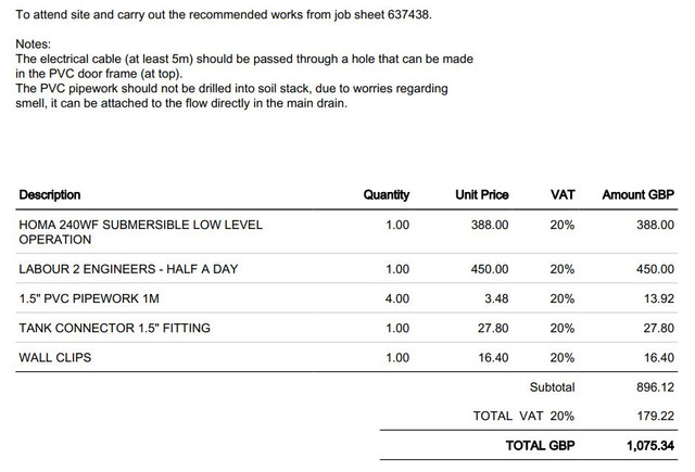

Thank you all for your advice i got a specialist in who i explained the issue to they recommended a low level puddle pump which would require no digging. There quote seems to be too expensive for me (Labour) for half a day if that of work

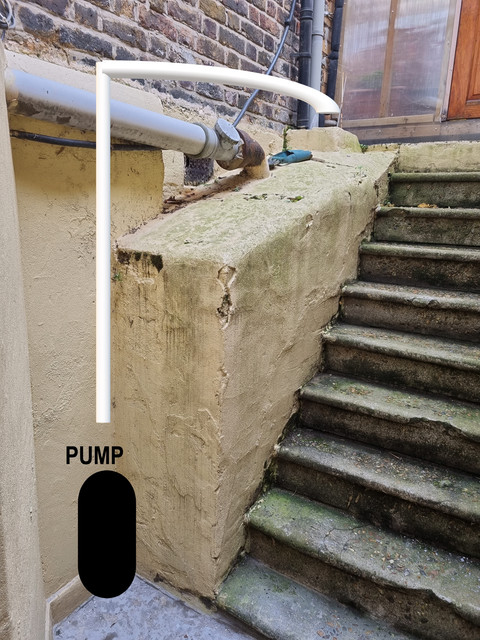

i would like to buy a low level puddle pump myself and get a tradesman to fit or attempt myself if i can work out which UPVC pipe and non return value i need
This a diagram of what i would like to get done
Any advice here ?
For plastic drainage a reliable brand is Hepworth. You could try contacting them directly and see if they can help, they might say no but you've nothing to lose by asking.
450 day rate for a groundworks engineer in London sounds about right - we paid 45/hr for chap who did our drainage for our extension and your hourly rate is only slightly more expensive than that.
Only slightly more?
With VAT added on it comes to 540. And assuming half a day is 4 hours, gives an hourly rate of 135/hr which is three times 45/hr.
