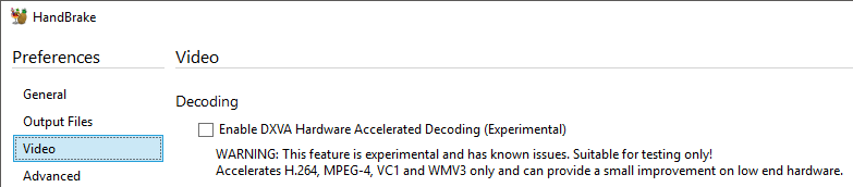

I just checked the GPU acceleration, it doesn't support h.265:
