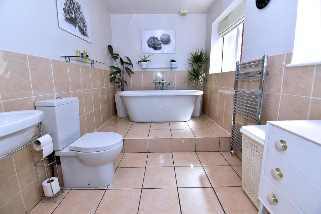

Our en suite has a freestanding bath that will need replacing and the tiles under it will also need replacing, however I am planning on keeping the tiles on the wall.

its a fully tiled floor and a flat bottomed freestanding bath, as far as I can tell the bath is siliconed to the floor but there is some movement
I think the bath has been in around 20 years,
as far as the water, its just overspill from moving around in the bath, and sometimes quite a lot of water spills out then just sits on the tiled floor until she gets out and mops it up.
EDIT found a picture of the bathroom on rightmove from before we moved in

I'm not concerned about the stain on the ceiling, it hasn't got any bigger in the last 4 weeks, I just want to try and prevent the future floor from getting water damaged (currently that step is chipboard with tiles directly on top of it.
Do it properly and remove that step.
We'll keep the step, mainly because we actually like it, but also means I won't need to retile the entire bathroom in doing so.
I've already retiles the floor in the lower part of the room but I broke quite a few wall tiles removing the old floor, so I'm going to have to be super careful on the step because I've used up most of the spare wall tiles

it's not like its a major life changing problem, but I'm thinking ahead, when I relay the part of the floor with the bath on it, it would make sense to add some additional level of water protection as a precaution
