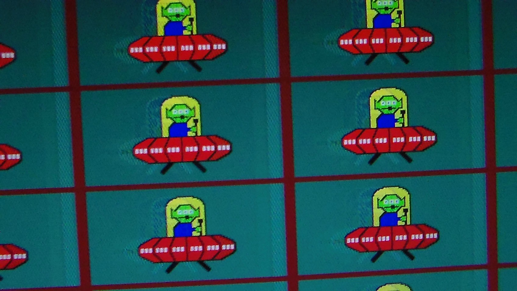

4) Massive changes to overdrive settings. (This would be worth a tftcentral review relook if they still owned the monitor). Pictures speak a thousand words, so i'll just let the camera do the talking here.
Ok first this is Premium AMA (hidden/toggle) on V4, which is about equal or equal to what V2 was at default on high.
(the default premium is even worse), since I don't have V2 anymore, this is a good place to start comparisons. This is what V2 looked like, more or less. It looks like benq took the V2 original settings and moved them here to the hidden premium toggle.
http://i.imgur.com/ObjKqFE.jpg
Ok this is the AMA high under normal settings on V4.
Contrast 43. Default new settings for V4.
http://i.imgur.com/q9jwDh4.jpg
Looks -much- better, right? The XL2730Z seems to look like this now.
*please note* lowering contrast with the default AMA settings does nothing to improve anything. It just gives many normal ghosting (especially black to white) transitions a white spectral appearance that is very ugly, making things much worse. TestUFO's alien invasion won't catch this, but other tests and the basic windows desktop catch it in spades. Contrast 43 is best for V4 default
Ok this is the new AMA high toggle, with contrast 43. You can toggle it by one of two ways: highlight AMA, press enter once, then press back or "exit" (pressing enter again seems to do nothing), or move up or down to off or premium then back to high.
Took two because I couldn't seem to get it perfect.
Pic#1:
http://i.imgur.com/aunM90Q.jpg
Pic#2:
http://i.imgur.com/N6PFHqJ.jpg
This new toggle is undocumented and did not work in V2 (in V2 it just intensified the overshoot). It seems to remove all of the inverse/overshoot by lowering the overdrive intensity, at the cost of more normal ghosting. Despite big improvements on testUFO, the increase in normal ghosting on sharp image transitions actually makes this a worse overall setting than the default untoggled one. But now there's some nice magic with this new setting. watch!
New AMA high with contrast set to 0. There is no 'spectral' ghosting drawback now!
#1:
http://i.imgur.com/zuDfOar.jpg
#2:
http://i.imgur.com/VAxNalP.jpg
#3:
http://i.imgur.com/KqUmsYv.jpg
This screenshot(s) does not do the quality improvement full justice.
If you test black to white transitions in windows, from contrast 43 to 0, you will see that (around the center of the screen) there is literally zero ghosting. It's very similar to the untoggled default with contrast 43, on white to black (which is good also), but without any inverse ghosting
Just lackluster contrast. This looks better than Lightboost mode, folks.
Yes this is at contrast 0, but this amount of overdrive quality seems to exceed anything on even the new Gsync/Freesync boards! Someone will have to do a reduced contrast test to compare. Note: any changes to strobe phase, strobe duty, single strobe or brightness value will reset the hidden overdrive toggle back to defaults. Contrast and Gamma will not reset it, though.
With a Vertical Total 1500 tweak, the default settings should be good for most users. The toggle with reduced contrast would probably be best for 2D side scrolling games, where inverse ghosting would show itself much more than 3D FPS games.
Pic#1:
Pic#2:
#1:
#2:
#3:
