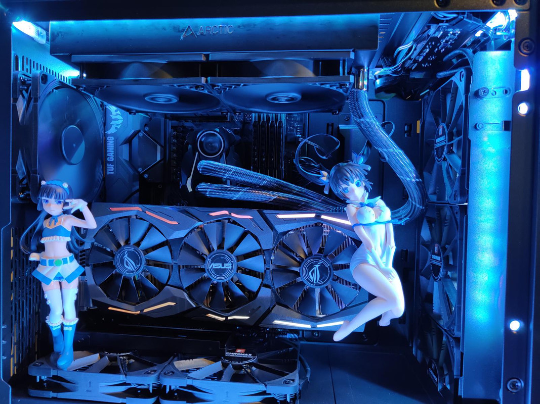

It should be compatible with a 240mm up top or is this just down to AF being so thick?
Edit
This not the lancool 2?
Edit
I was struggling to get mine to clear the memory modules. Maybe I had not tried to mount it forward enough in the case. I'll take a look at this. How are your gpu temps using a vertical mount. I like the idea of it, but had red and seen stuff saying its not advised? You have the bottom fans set to intake yes?
Nothing wrong with vertical mounts so long as you spring for a decent ribbon cable. Any cable much short of £30 is going to be problematic. In addition, there are no cables yet (AFAIK) that can do PCIE gen 4.
