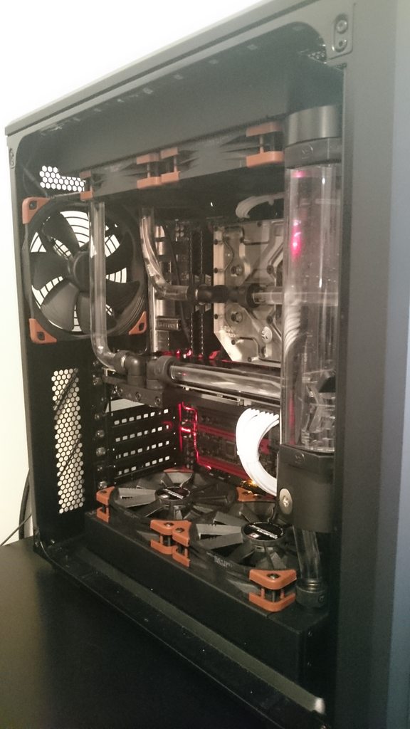

I had the same dilemma and looked at the same cases as you did, and took weeks to decide.... To stick with my Corsair Air 540, and I'm really glad I did.
I've just finished the loop and I'll post some pictures later.

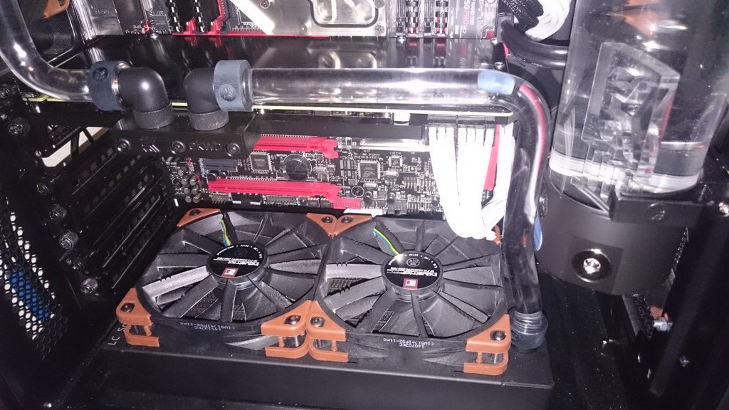

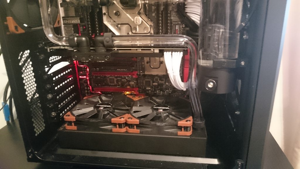

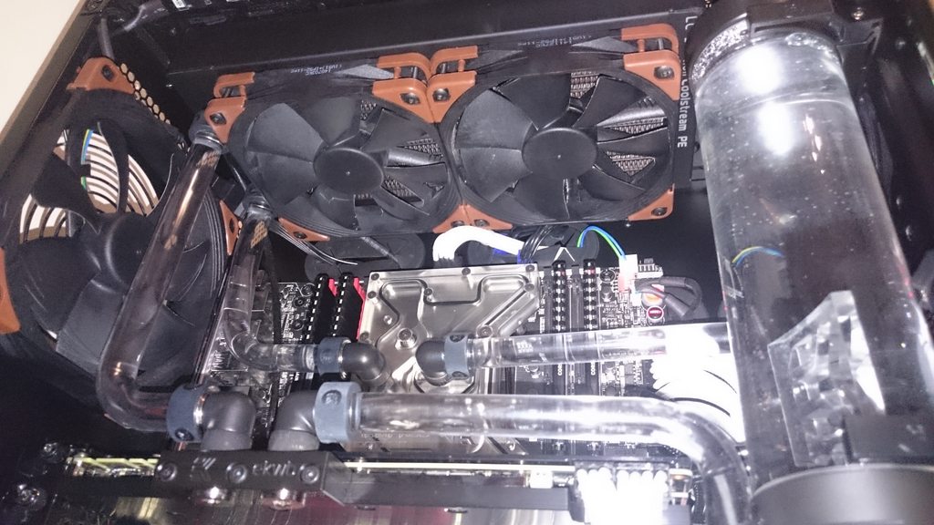

Photos aren't great, but you can see the options (you're biggest restriction IMO is the EATX mobo).
I went for this case because the pump, drain and PSU all go in the back which leaves plenty room in front. To go SLI would mean the addition of card and bridge only (or even just leave the second card on air if preferred for short term SLI solution). I prefer the larger res at the front as opposed to a 360 radiator. It took a bit of modding, but that was all part of the fun for me.
I like my case on my desk, and I felt the alternatives where just too tall and cramped.
