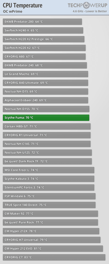

Do not get locked in by a few degrees, its not worth it, even for stability results - you dont run the computer 24/7 prime bull turd
take a look at this chart the Notua's - 3 degree diff n15 and the smaller, latter designed u12
[/URL][/IMG]
So easily disturbed by fan noise, whines, anything really, even my typing, ha! They are so damn quite, not saying Noctua are the only ones, but myself have used them since they came out, quality, each time, even their paste, not use other!
