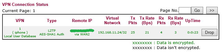

My VPN connection on my Vigor2920 is configured to require IPsec and I can connect from my iPhone.
