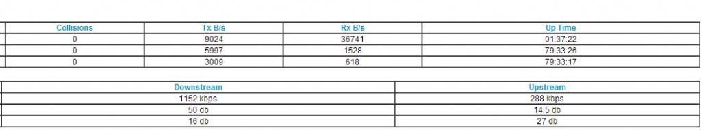

Edit: I've now unplugged the other line and the ping appears ok now, 24ms. The DL or UL hasn't changed from 0.93/0.24.
Apparently I should be getting between 1.5 and 3.5mb, what do you suggest I try next?
