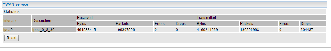

out of curiosity what is your errors like?
How many in a day ish?
Don't know about per day, but that's the details since at least last sync or reboot... which has been at least a week+
For some reason, your image has uploaded at too low a resolution and in a really really bad quality - so I can't actually read any of it!
But... I can see five digits where I have one... maybe increase your SNR one dB and try?
Altered the piccy

still seems a bit off but readable I think:o
Altered the piccy
