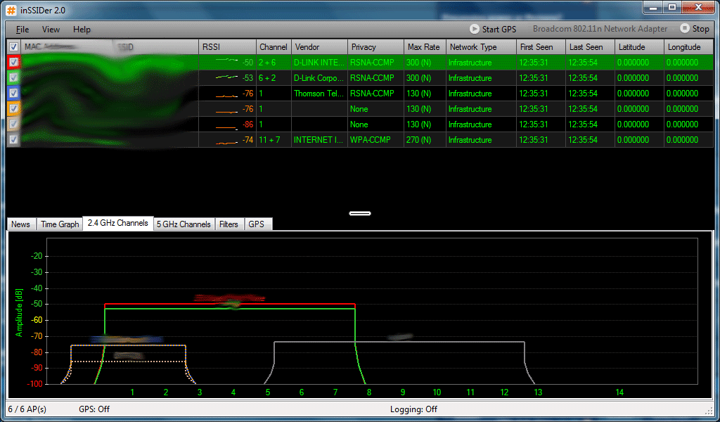

Best settings for router - is there software for it?
Sorry I don't know of any, but you could try this in CMD prompt and make an educated guess as to the best channel.
start->run->cmd
netsh
wlan show networks mode=bssid
How do I interpret the results?....I can clearly see there is another router using exactly the same channel(s) as me, but there seems to be routers spanned across all the channels.

I'm the top result:
