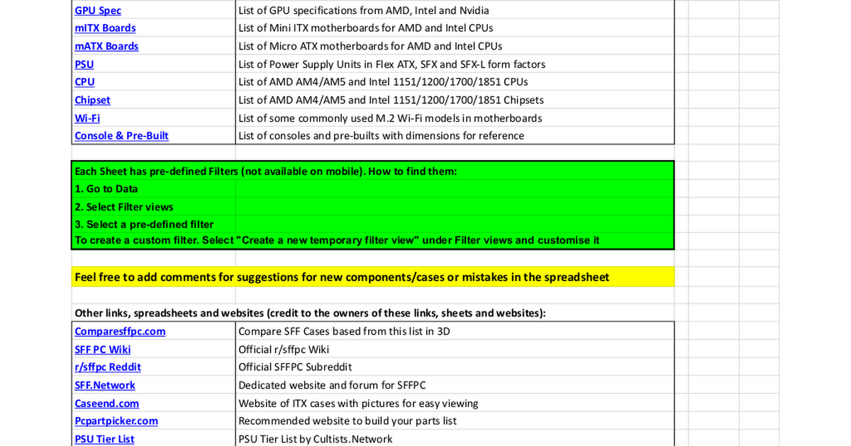

There's a long-running SSF parts compatibility spreadsheet here:
You can filter that down by GPU length, width, height, model, and even PSU requirements. There are even a lot of 50-series cards on there already.
