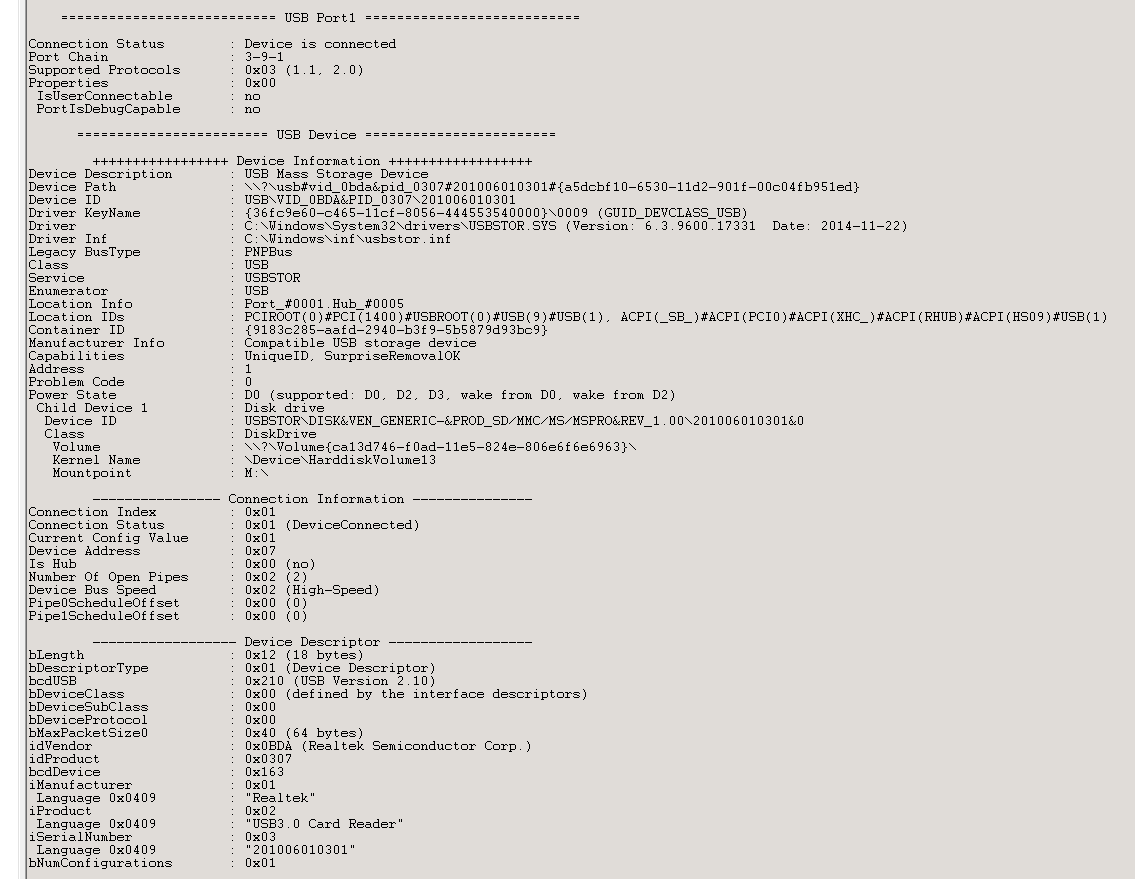

Also, be aware that some USB 3.0 Card Readers provide a USB 3.0 compliant port, but only provide a USB 2.0 interface for the Card Reader.
I thought my monitor card reader supported USB3.0 because of this...
But after digging a little deeper with usbtreeview, I found this....
See how it shows the same "USB3.0 Card Reader" as the name but only supports USB2. :o

Also, although this unit is marketed as a USB 3.0 Card Reader, only the USB port is USB 3.0 compliant. The card reader is reported as only having a USB 2.0 interface. They don't make that very obvious in the specification!
