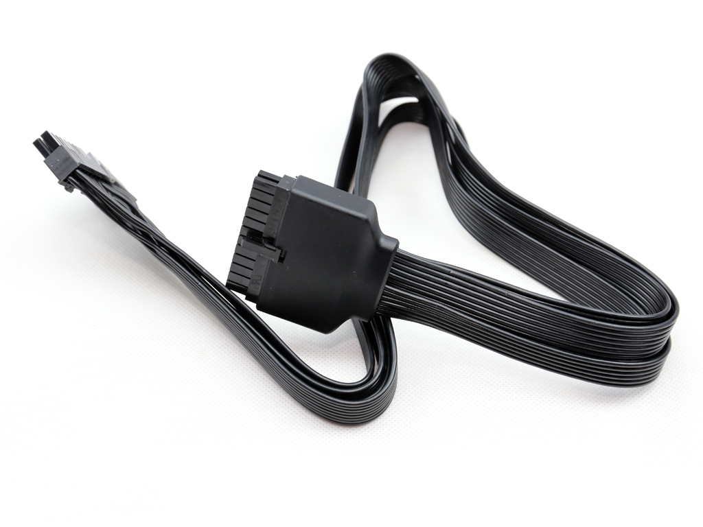

There is a review here. The downside is that the 24 pin ATX lead has a large cover over it, see here. I suppose it's there to cover the capacitors. If you can live with it then it shouldn't put you off buying what is a very good psu.
