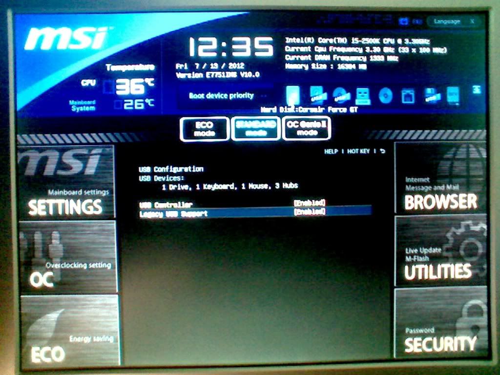

Ok so i went into the BIOS to see if the optical drive was showing up this is what i found (sorry for the bad quality pictures i cant find a USB stick or i would use the print screen function in the BIOS)
http://i831.photobucket.com/albums/zz240/whitescar911/Picture1.jpg
As you can see there is a UBS drive in there somewhere.

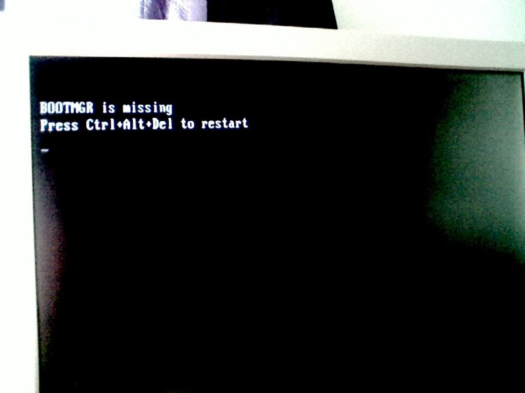

However after changing a few things, i can no longer get past the BIOS and don't know what i did and how to undo it. This is what i get when trying to boot from my corsair SSD that has the OS on it.
http://i831.photobucket.com/albums/zz240/whitescar911/Picture4.jpg
Something about No device found.

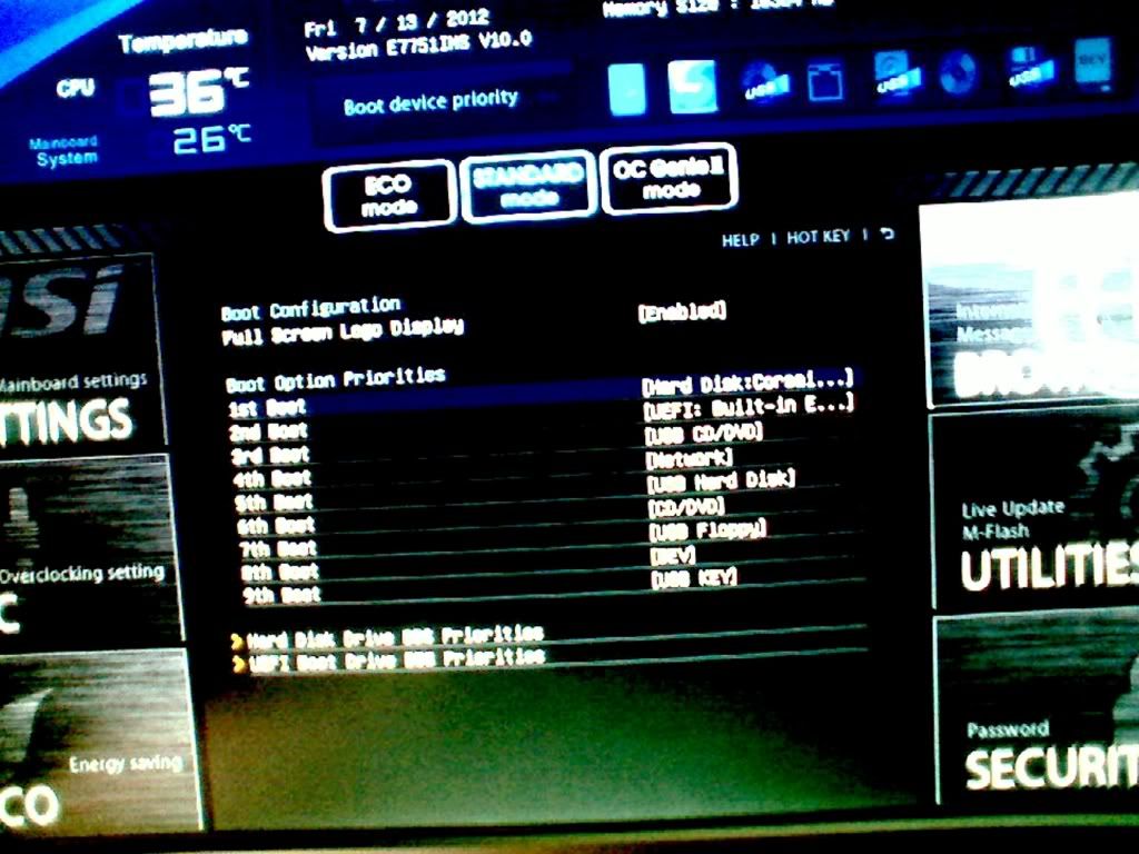

This is my boot priority list
http://i831.photobucket.com/albums/zz240/whitescar911/Picture3.jpg

Ok, the boot manager is corrupt so it won't boot windows. However, it seems that your bios does recognise the dvd drive so you should be able to boot off the disk.
You'll need to change the priority for the devices, so make the dvd your 1st boot. Restart it and it should pick up the windows disk and start to boot from it. You can then try and repair the boot manager sector.
However, as you never reformatted when you installed the new motherboard you may still have driver conflicts. Do you have anything on the drive that you desperately need to keep? If not it would be much better to do a fresh install rather than running a repair job.
