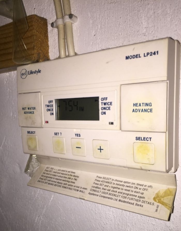

Hi All,
Had a power cut on Friday, this always resets the thermostat, so I set the correct time and sorted the time for the hot water to come on twice a day.... the problem is I am no longer getting any hot water at all...
The light comes on the thermostat to say it should be heating the water, the pilot light is on the boiler but nothing, the airing cupboard is cold too.
Anything I have missed before I call someone out to take a look?

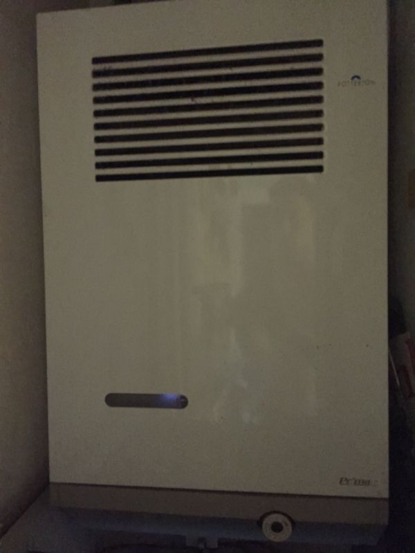

What else can I check before giving in? The pilot light is on and if I turn the thermostat off and on the boiler responds like it should be doing something but none of the water pipes coming from the boiler get even remotely warm....? :(
the pilot is on but it wont fire up, the boiler needs power to open up the gas valve, so test the power going into the boiler, is it live ? if it isnt, maybe a faulty thermostat or timer, if it is and power is being send to the gas valve, then its a faulty gas valve..

Funnily enough I've just been to one of these boilers today, not the OF version but the FF. Still 24 years old tho.
Same issue, lights the pilot but not the main burner. Sadly for the customer (and by the looks of things possibly yours too) the fault lies with the gas valve not opening the second stage (main burner) solenoid. Part is obsolete, so new boiler time.

Thats not great news to read above.... because thats exactly whats gone wrong! faulty gas valve and guy was going to find out today if you can still get the parts... which reading above seems like you cant...and the thermostat overhead valve or something is also on its way out.
Not what I wanted lol, and he is booked up for 6 weeks for a new boiler install.
He also checked our hot water tank and the original installers sealed the hole for us to be able to install an immersion heater... could just buy a new tank and immersion to get around the hot water for now until he can come install a new boiler because he is going to be massively cheaper than what British gas will want for a new boiler...

potterton prima gas valves are not obsolete :rolleyes:
If it had a white rogers gas valve you simply fit a Honeywell with the conversion kit
Let me guess you told customer its obsolete and got them to have a new boiler off you :mad:
We were told by Parts Centre that the White Rogers valve was obsolete, and the Honeywell replacement was unavailable. And no we havent fitted a new boiler.
The office is looking into sourcing the required parts from elsewhere, while the customer decides whether its worth repairing a 24yr old boiler or replacing it, which they said they would prefer to do.
