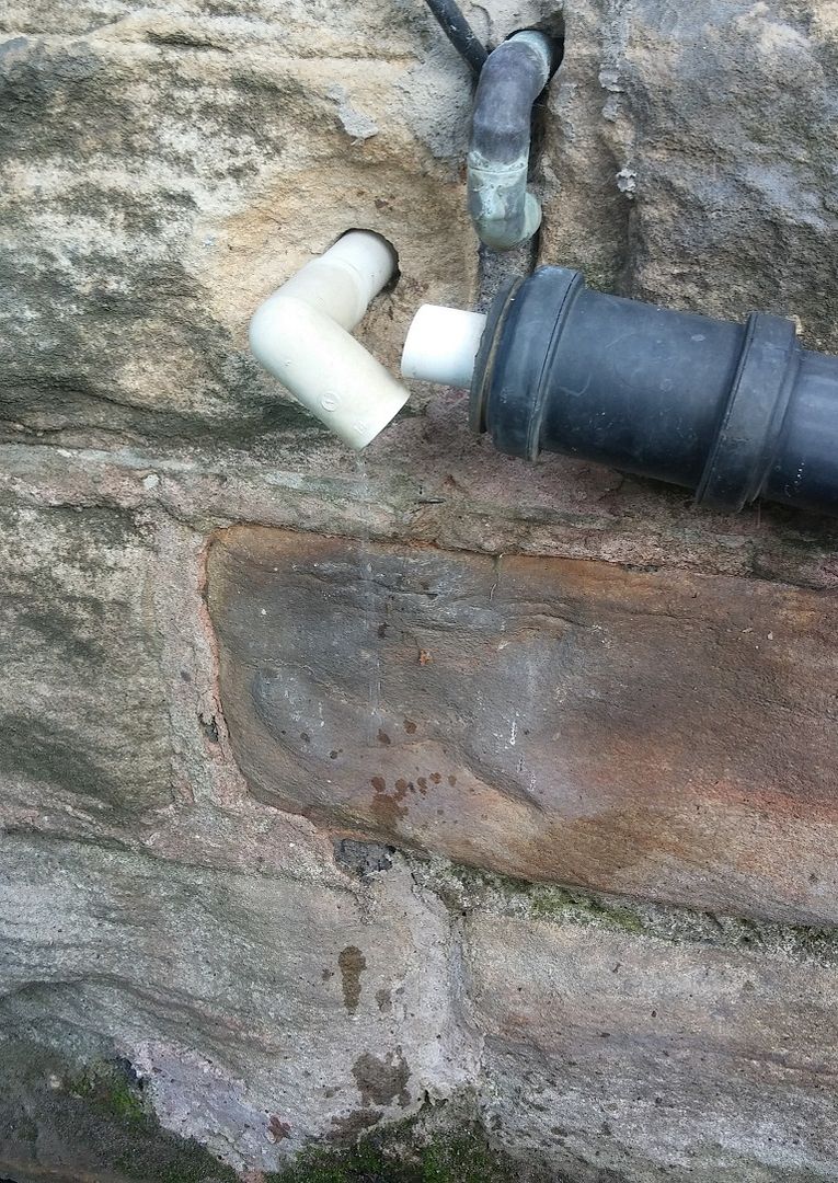

I re-pressurised the boiler to 1.5 bar with it turned off and it lost pressure. Water is coming out here (plastic bend, disconnected just for the photo):
I would estimate it took as little as 15 mins to go from 1.5 bar to 0.5 bar.
Any ideas?:(

If you want to confirm the failure, then pressurise the system, and isolate the boiler from the system using the F&R valves, and watch the pressure gauge. Boiler has to remain dry (no leaks dripping from the boiler itself) and the PRV outlet needs to remain dry (copper pipe in your picture above). Obviously do this with the boiler electrically isolated. If unsure get your heating man to do it.
