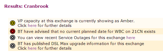

Exchange Name: Cranbrook
Exchange Distance: 2.1 miles (by road not straight line)
Broadband Estimate: 4.0Mb

Did you do the 'third' test after this?
Solved!!
Speed now 4.26mb!
Plus Net support had told me to alter the router settings to PPPoE before Christmas, I just changed it to PPPoA and voila!
