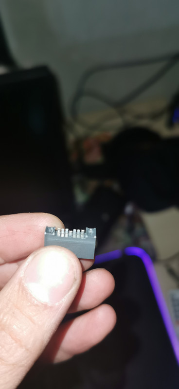

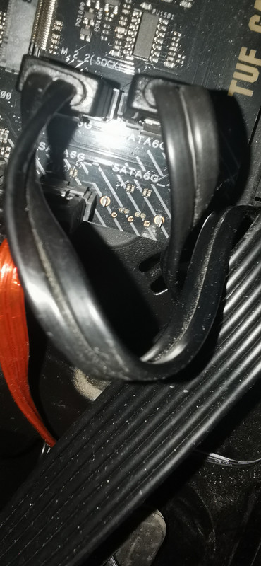

Hi everyone, so I decided to go full idiot and today I did this
I've got the other 3 working fine but I want to be sure this won't affect any components.
Is it ok to keep using the motherboard or should I get a new one?
Thank you in advance.
If you have the soldering skills, just desolder the broken sata connector and fit a new one. I did this and it worked perfectly. I then promptly fitted an M.2 drive which disabled the repaired sata port, ffs.
