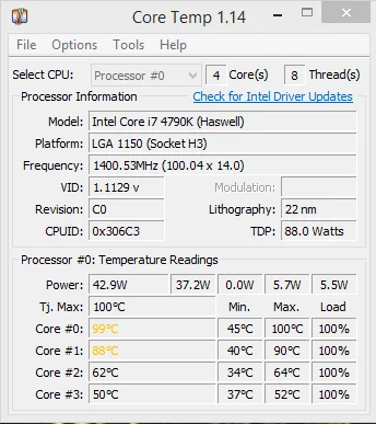

My friend's CPU keeps thermal throttling.
I've reapplied thermal paste twice. Heatsink looks fine, no warping (BeQuiet Rock Pro 2). I've under-volted from stock too.
BIOS is reporting 91 degrees when not even booted into the OS.
Interestingly CoreTemp is showing 2 cores are red hot whilst the other two look normal:
Could it be a busted sensor or shoddy thermal paste in the IHS?
Haswell had some proper crap in their IHS. Try a delid. Nothing to lose at this juncture.
Yeah looks like that might be the case, I'll delid it when Ryzen 3 comes out. Worst case scenario he can get a 3600X or something.
Was the 100% load intentional?
Yeah I was running Prime95 to see if there was actually any heat, had my hand next to the heat-sink and it didn't seem hot at all.
Delid and see, its so easy. I don't have a delid tool but have been using a vice, block of wood and mallet since Ivy Bridge and its literally 3 seconds. I know theres talk of microfractures with this method but no cpu has failed up to now.
