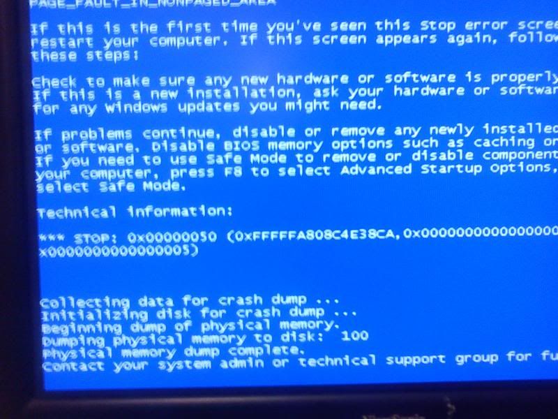

Been getting a few crashes lately on my second rig, resulting in the following blue screen. Sometimes the system will run for a few minutes before crashing, other times a few hours.

Getting the following wazza with who crashed.
0X50
0X1A
0XD1
0X1E.
Theese were just from today, first 3 seem memory /qpi related, the last mentions v core. System is at stock speed.

oX1A crash again. Looking like another trip to the members market soon for a triple channel ram kit.:eek:
