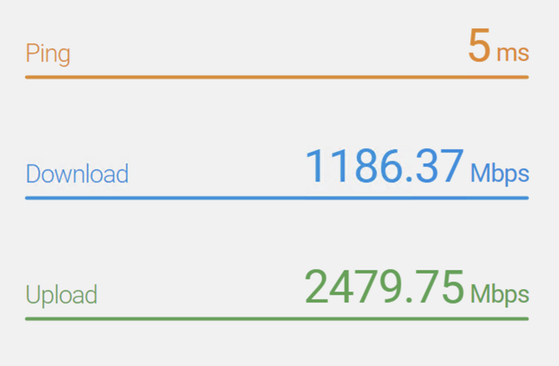

I've had good results with speedof.me in the past, but it's giving figures all over the place today. What results do you get from https://speedsmart.net ? Their download test only gives me about 500Mbps, but the upload figure is good.
Only 500 Mbps down but full upload. That's from a VM though, will try tomorrow on a proper client.

What results do you get from https://speedsmart.net?
I just tried Speedsmart - I'm getting between 600 and 800Mbps down depending on what server I choose, and 112Mbps up regardless of server.
