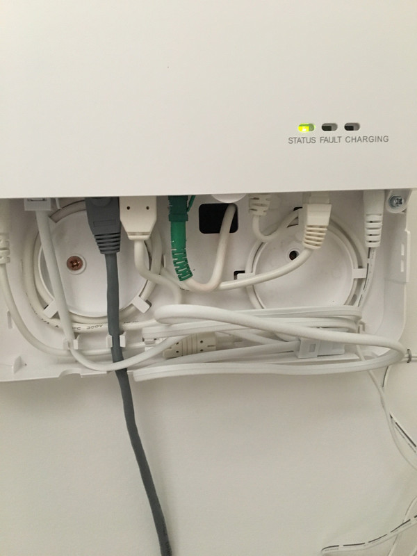

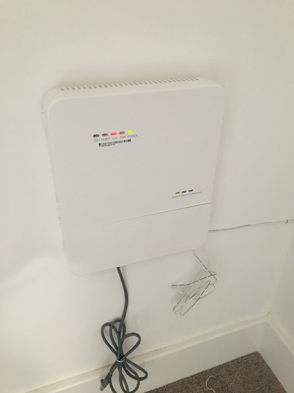

Openreach have installed the modem under the stairs.
Looking around the intranet it would seem that I'm going to have to plug the BT Superhub that's arriving tomorrow into said modem. Which if true I find to be absolutely absurd, given that I expect most people wanting an Ultrafast service to use the ethernet connections. Spoke to someone at BT who brought up power line adapters as a solution but is that going to get me the same speeds as if my devices (ATV 4K/PS4/TV) were connected directly to the Superhub?

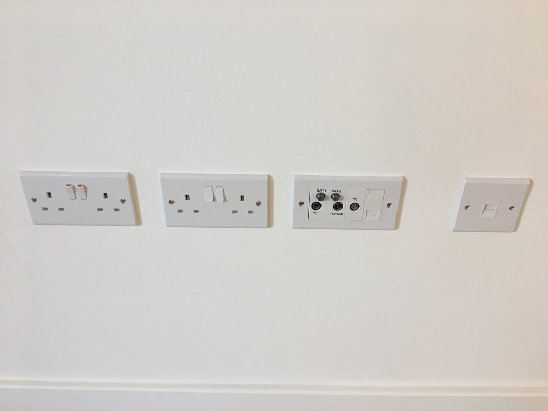

But I'm just wondering if I can plug the Superhub in the living room via the outlet available here on the second from the right (is the lift up port next to the tv (next to the FM/DAB connection) an ethernet connection?):
And it work just as well? Or could I just use the phone line at the far right?

If those are phone outlets, then no. The grey cable hanging out of the ONT is the ethernet into your router.
The house builder has full control of the ONT placement as well as the decision of how much network cabling to install into your house, looks like they couldn't be bothered to think in this case.
Where is the ONT in relation to where you want to have your router?

Well this is my issue - the one at the bottom looks slightly larger than a phone outlet which I'm wondering if it's an ethernet port.
As mentioned, the ONT is under the stairs. Ideally I'd like the router next to the TV unit (where the plugs/connections are).
If it’s an Ethernet port it must have another end somewhere.
Well this is it. But the only ports I know of are in the cupboard under the stairs. Which means I'm probably screwed. I'm even wondering what the wi-fi speeds are going to be like with the Superhub closed away....

You seem to be saying the both the ONT and the other end of that Ethernet connection are both under the stairs. If so what's the problem?
I'm not sure that the port in the living room is an ethernet connection - this is what I'm saying. But the first pic I uploaded shows a grey cable which is an ethernet cable so something has to be put into that.

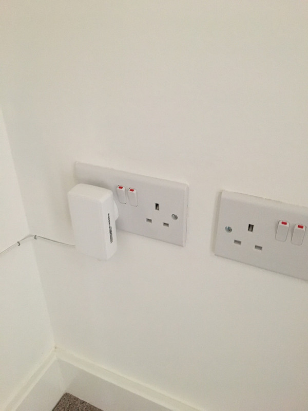

Yeah the superhub will go next to the ONT. I was fortunate as we got FTTP after we moved in so I was able to have the ONT installed next two ethernet ports in the living room. You'll either have to reply on wifi, powerline or run ethernet sadly. And I used powerline temporarily and it was a disaster, they would drop out regularly and need resetting. I'd say don't bother going powerline, if you can go ethernet, even though its a hassle.
Edit : Should add the powerline drop outs were on a new build as well.

So just to counter that, I used powerline adaptors at my last new build rental and they where absolutely fine, no dropouts at all, I only had a 60 meg connection at that place. It did add ~ 8 ms latency though.
I get BT ultrafast 2 connected tomorrow so happy to do a quick test and let you know how they cope if that helps at all.
