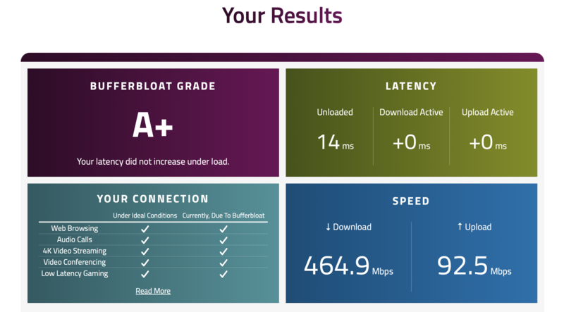

This is the result with the new router.....
The amazing thing is that NOTHING is configured in the new router. It seems that the problem was the old router - which I specifically bought becuase it was supposed to minimise things like buffer bloat.

The amazing thing is that NOTHING is configured in the router. It seems that the problem was the old router - which I specifically bought becuase it was supposed to minimise things like buffer bloat.
Consumer 'routers' are mostly overpriced useless tat, anyway, tbf. You still didn't mention what was the outgoing and the new router model(s)? It'd be interesting to know for future buy/avoid recommendations for others. I'm glad you got it sorted! Fibre doesn't tend to need much by way of SQM anyway, usually. Your router was probably slowly dying, overheating or similar and the packets were hitting IOWAIT or some such, causing the symptoms you experienced. All's well that ends well. Enjoy (and don't forget to tell us what the routers were/are! :p).
I am almost embarrassed to say now it was a netgear XR1000. *cringes* Sorry, I fell for the hype, but in my defence I am a network idiot. The new one is an Asus with Merlin. Not that it needs anything - out of the box it is working way better than the netgear.

On the surface I am guessing that the XR1000 has a throughput issue. I didn't spend much time quantifying it, but my guess is that it's around 150Mbps. Anything after that and it starts to introduce the very problem it's supposed to solve. This may be down to the pppoe, I don't know.
