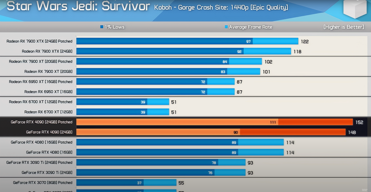

A 7800X3D + 7900XT is the sensible option, not worth buying any of the Nvidia gpus under the 4080 since 12gb VRAM wont be cutting it for long and once you're spending that kind of money you might as well just get a 4090 as its so much better than anything else.
A 7800X3D + 7900XT is the sensible option, not worth buying any of the Nvidia gpus under the 4080 since 12gb VRAM wont be cutting it for long and once you're spending that kind of money you might as well just get a 4090 as its so much better than anything else....
That may be true for rasterization based gaming, but I need the card to also cover RTX, video encoding & editing, VR, and AI processing. From what I have seen, AMD falls behind in all of these areas, doesn't it?
As for the 4090, it's double the cost of the 4070ti. I've fallen into the trap of thinking like "you might as well just spend more for that price" but where do you draw the line... if I'm going to buy the 4090 I may as well just also spend "a bit more" to buy the most expensive CPU too, and before I know it I've gone from spending £2000 to £4000.
I'm not sure Jedi Survivor is the best analogy of things to come to be honest...it's horribly optimised. The main issue seems to be developers relying on direct storage on consoles, and the lack of DS implementation in PC games is artificially stretching the VRAM demands on PC gaming. If they don't fix that, even the 4090 won't have enough VRAM in a years time.
If it was me and you can't go AMD I would definitely be looking at a 4080 minimum. If you plan on keeping the card for a few years. I think 12gb will become the bare minimum but 16gb the recommended in much sooner time then we think. 4080s can be had for 1100 - 1200 so not too far off your budget.
It’s not that I can’t go AMD, I’ve been very tempted to go that way, because for rasterisation-gaming they’re the best bang for the buck by far, but once you factor in my other requirements and the quality of DLSS2 (and now the potential of DLSS3), the Nvidia option becomes much more competitive.
Would the AMD options perform better than a 4070ti at 1440p while using DLSS2 and/or DLSS3? That’s the question I was hoping to get some clarity on. Of course my other requirements and use cases had to be considered too, and I personally have no knowledge of AMD’s performance with AI, encoding, and so on.
