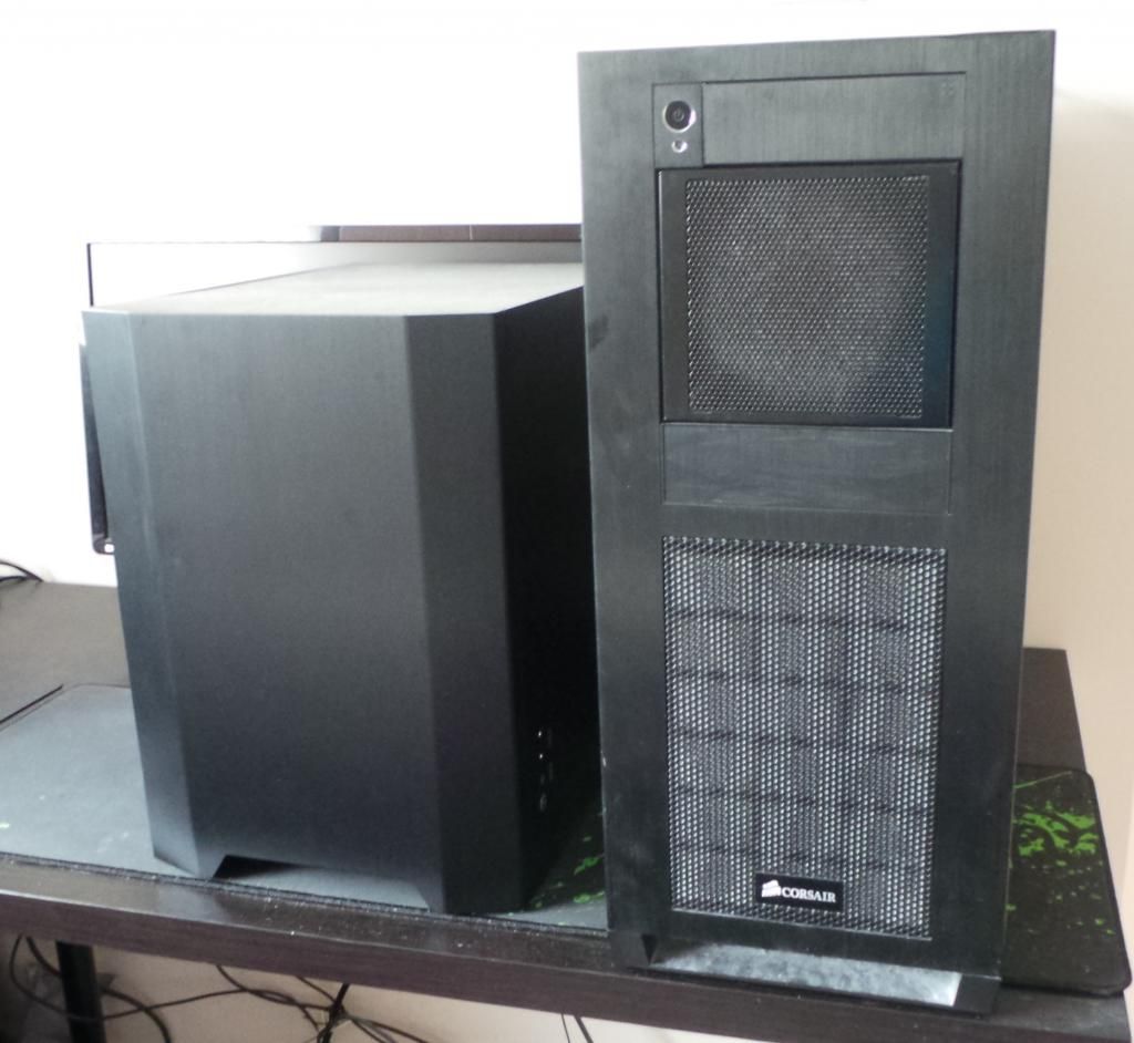

New vs OLD

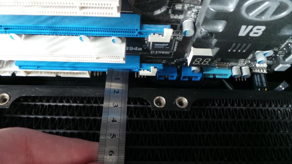

Quick check that the rads will actually fit! The bottom RAD is far to thick and it covers bottom 2 PCI slots and blocks my USB 3.0 header. This was a mistake on my part and i will be replacing it with a smaller one.

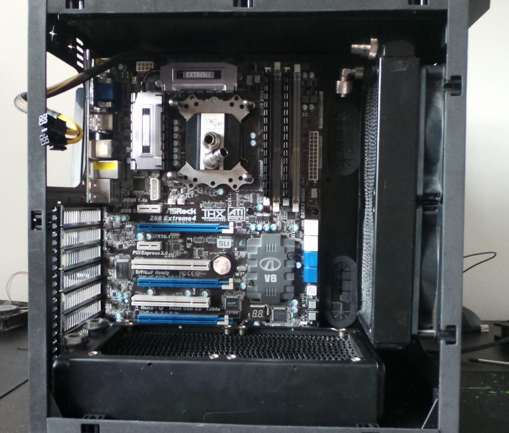

Gap behind the RAD
Compromise on the front rad mounting, because the bottom RAD is so thick i had to shove the front rad as high up as it would go, this means the bottom 2 holes are not secured to the case! Fan filter will also not screw on and is just held in place by the magnets

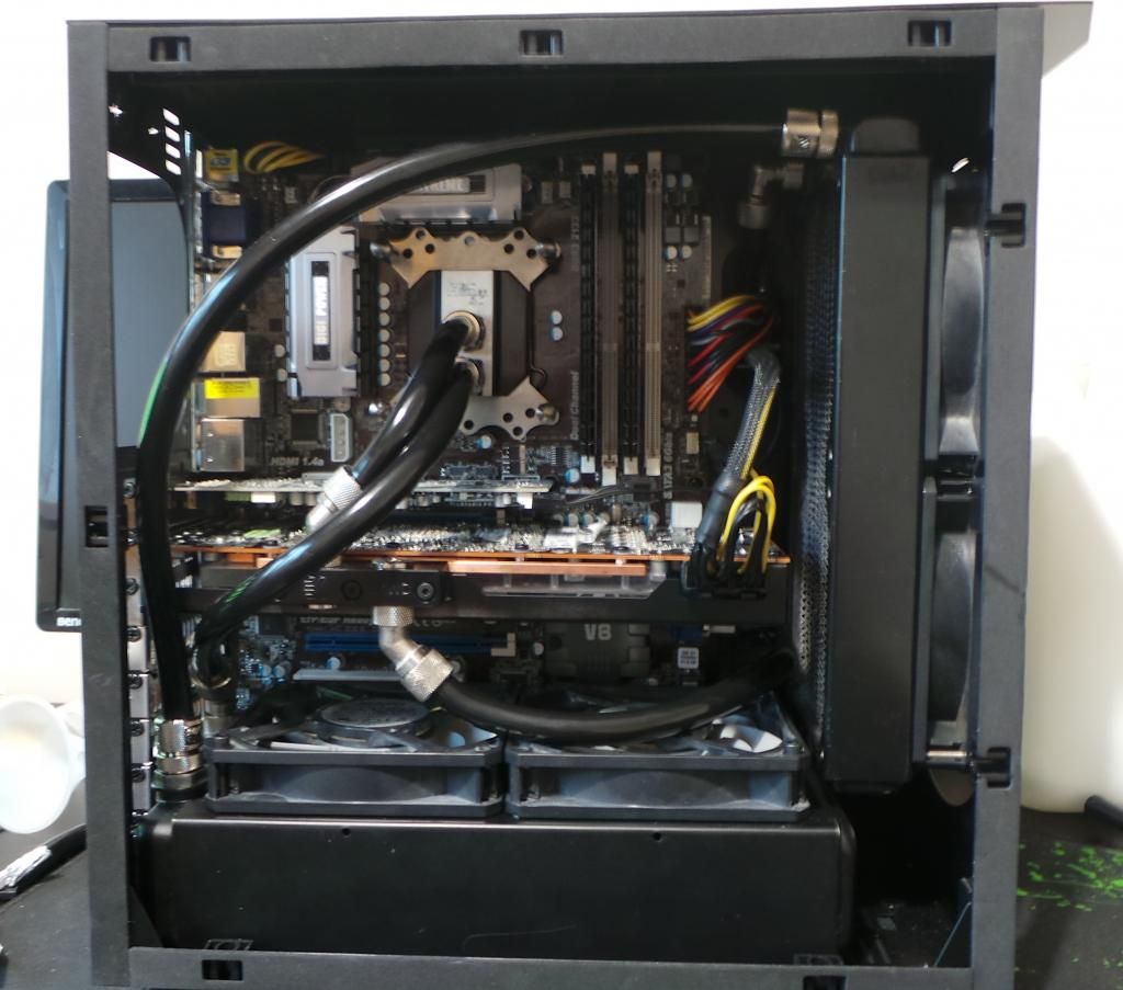

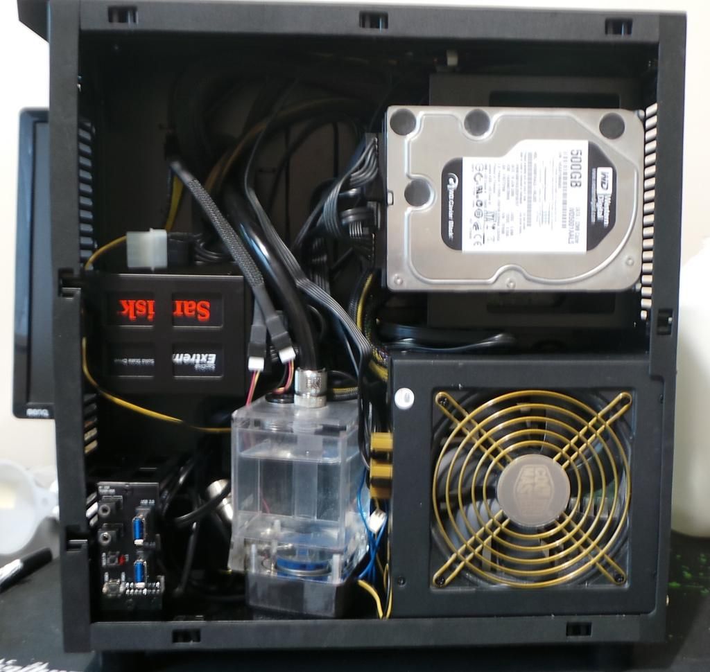

Behind finished. Its a mess and a very tight squeeze but like i said i will be redoing it soon

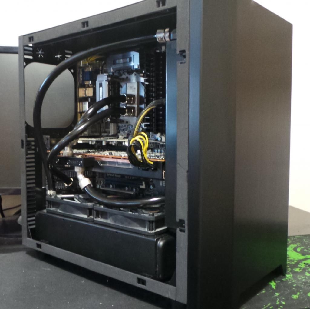

Front side. Left it without a fan in the back atm, with all the rads as intakes the air is being forced out as it is.

Overall the build quality is very good, Hard drives could do with some sort of anti vibration though, its all metal on metal and one of my drives is quite loud.
Its a hard case to do a full loop in, you quickly run out of space in the back compartment but with better planning you could do a much better job than I have.

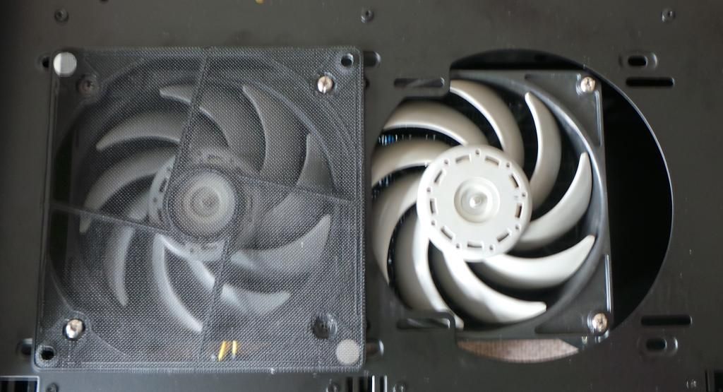

After seeing that I am now 100% sure that this is my next case. As I won't be having any watercooling I guess I will have acres of space to put my rig together in. What's the size of the fan hole at the back? Also is there any space for rubber grommets on the HDD tray?
