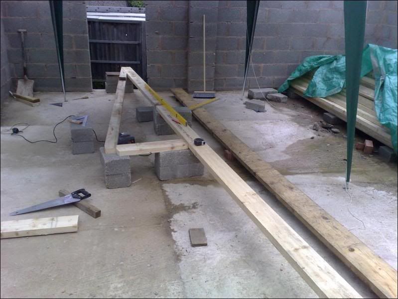

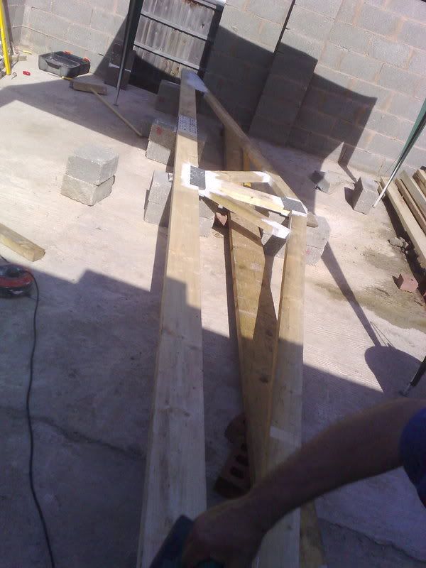

If all goes to plan (i know it wont) the roof should be built & in place in around 4-6 weeks, anyway, here is some progress on our first day putting the roof together.
Major pain in the arse getting all the angles right on this first truss, going to test it with a fair bit more weight than it'll ever take in real life then make another 10 of them, that's gonna take a while!

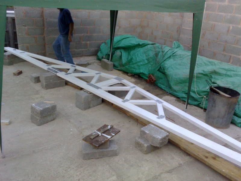

Truss number 1 complete-
Yeah, we've had a council engineer come & check everything stage by stage too, but to be honest when my car is gonna be parked under it i want to see for myself that it aint gonna cave in if we have a few feet of snow.
So it's gonna get loaded up with a rather large amount of concrete blocks.

Iamzod, I know the feeling, despite the fact the calculations have been done by the professionals it's still something you'd like to check yourself if possible ;)
With our garage our plans called for 9x3 inch timbers for the main supports (original plans were for several layers of ply, then felt, we went with profiled steel in the end - which weighed less), and tested it by two of us hanging off the beam once the first one was up :D

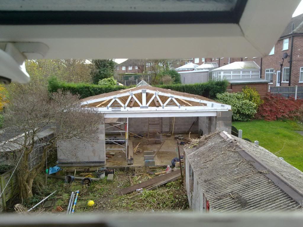

Anyway, still have the Capri and therefore still need a garage so work started again back in summer 2010, bet my dads neighbours loved him for leaving this half built so long :eek: . Lots of roof trusses were needed, 12 i think from memory, these took forever to build as it was all done from scratch with wood, nails & truss plates bought from some place local.
The trusses were just sat stored for almost 2 years, but the roof got built properly in the summer, doors fitted, there is now electricity in there etc.
As of January it looked like this after the roof was done, doors on, walls rendered, everything painted. Old garage came down too which was made of lovely asbestos, about 3 days after this last pic was took it got buried under 15 inches of snow, so at least we know the roof can take it :)
Still lots of work to do on drainage, obviously lots more concrete to go down for the new driveway, the ceiling and insulation needs to go up and then the lighting can be properly fitted although there is now electricity in there but currently only a few plug sockets connected up for temporary lighting/using tools.
