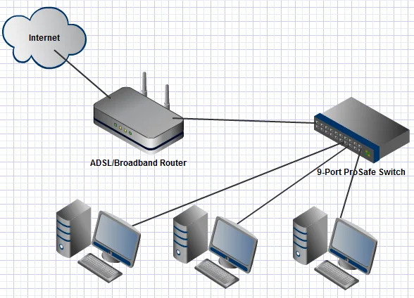

You'r really complicating things for yourself having two separate networks, you won't saturate the entire network by gaming/sharing files/streaming between PC's as that's what a switch is designed to stop happening! I'd highly recommend you set up your network something like this:
This lets your router handle DHCP, DNS and Internet access while keeping all gaming/streaming (local)/file sharing(local) on the switch at Gigabit speeds, if you have Gigabit NIC's in all machines of course.
