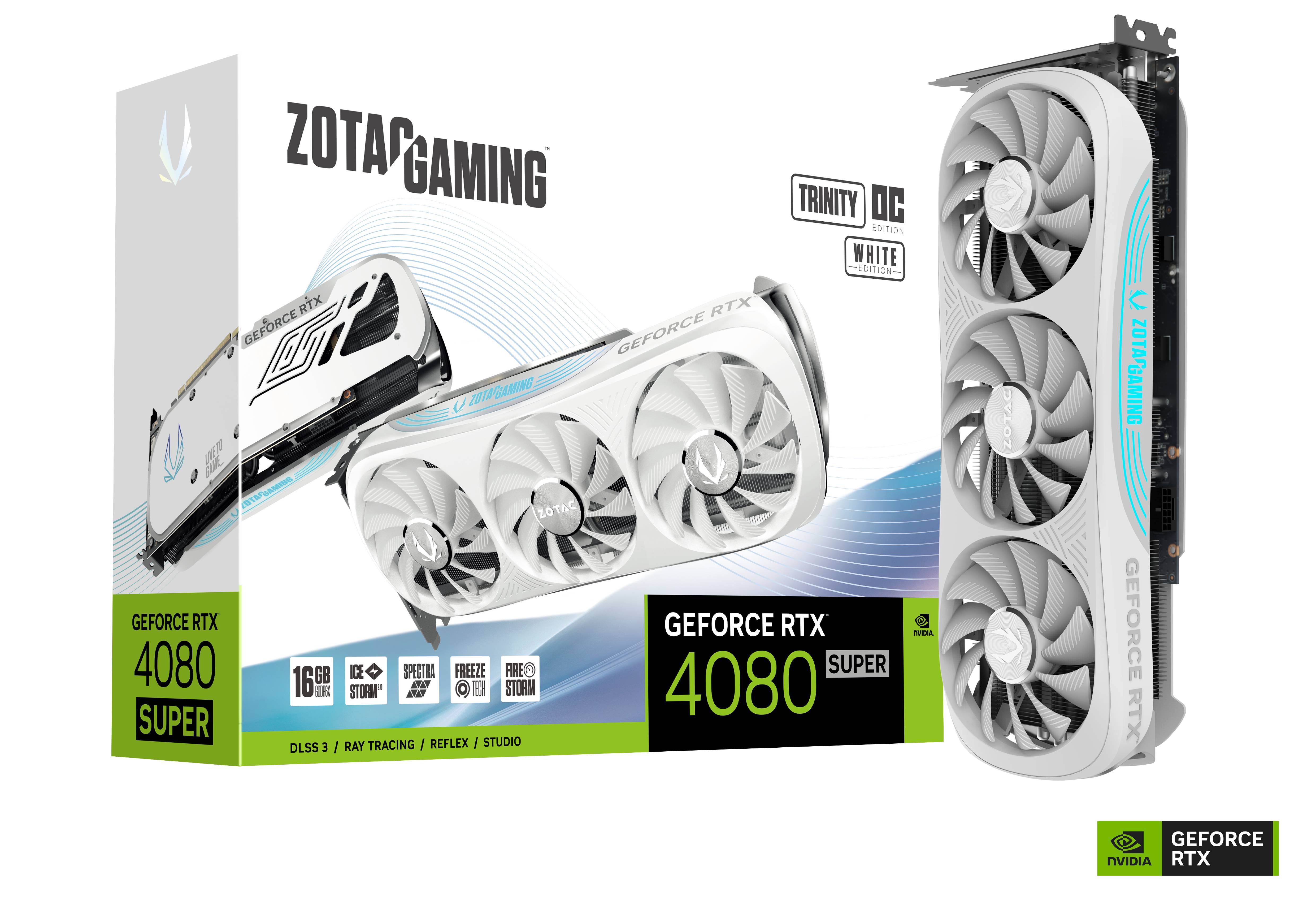

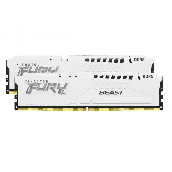

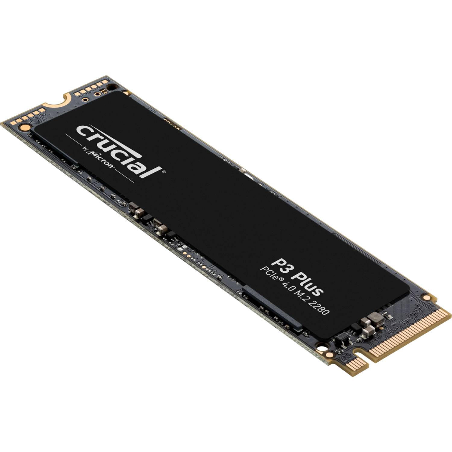

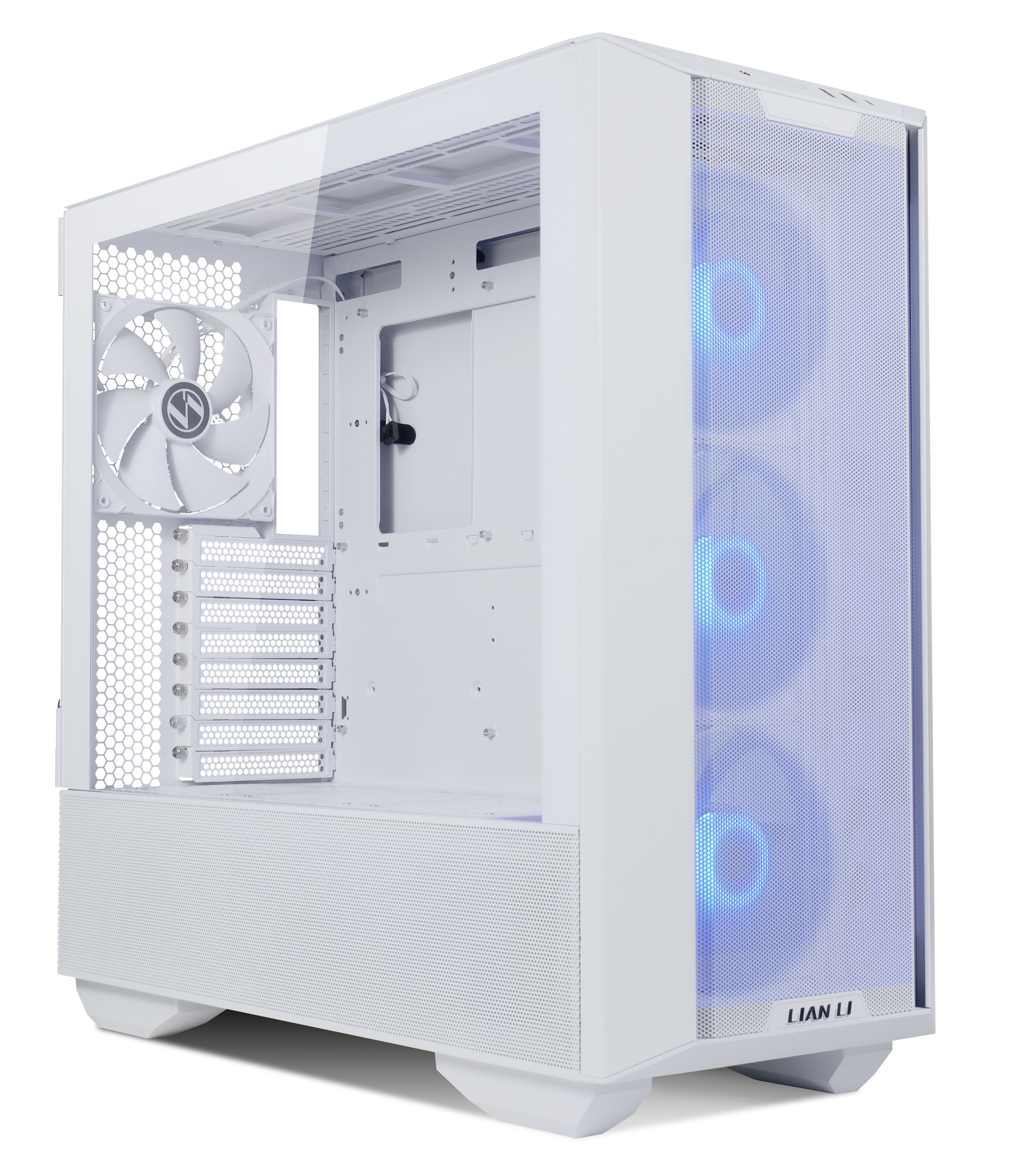

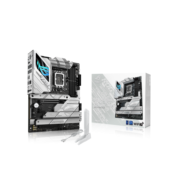

Ok so my friend wants me to build him an all white setup with his budget set around the £2500-£2700 mark. I have tried to get it as all white as I can, what do you guys think? can I do slightly better regarding the price or build? thanks.
My basket at OcUK:
Total: £2,646.89 (includes delivery: £0.00)​
£459 (incl. VAT)
£440 (incl. VAT)
£146 (incl. VAT)
£130 (incl. VAT)

If it is a gaming PC only, you could easily step down to an i7, with a cheaper B760 or Z790 board and downgrade the AIO (or switch to a peerless assassin/phantom spirit) and case choice.

The PSU and memory are black because the motherboard sockets are black.

Swap the Crucial P3 Plus to something better if it is going to be the main drive.
The T500 sugested by Tetras Looks good and maybe the WD SN770 for the 2nd drive.
If you do go for the SN770 make sure to update the firmware as it has a problem with latest Windows.
