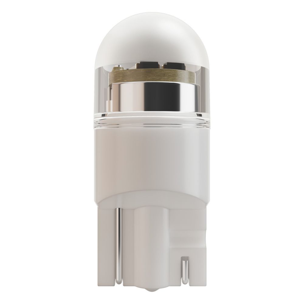

otherwise, I follow advice in many earlier threads of (h7) philips + 30% bulbs ... yellowish sidelights annoy me so my first leds maybe some w5w sidelight 4000K's

probably not - the osram w5w I mentioned probably has no certificate like V
LED replacement for the Osram Original W5W and suitable for all vehicles with conventional W5W lamp bases. Provides a modern, intense light and has a temperature of up to 6000K. Offers an easy upgrade to LED technology with 'Plug & Play' system. LED retrofit lamps can use less energy than standard lamps. This product does not have ECE approval and must not be used on public roads in any exterior application.
